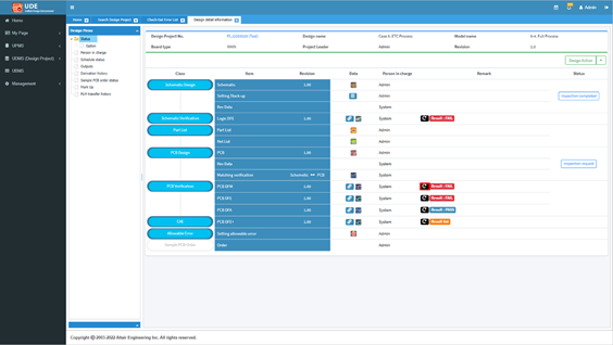

If there is a PCB verification process in the design project, the verification will be performed automatically after generating PCB outputs.
However, the verification conditions should be set in the process settings when registering the design project.
After the verification is completed, the status is changed.
- Click
to display the PCB design. PollEx PCB will be
invoked to display the design. - Click
to display the rule information of verification
criteria. - Click
to display the DFM verification results. PollEx PCB
will be invoked and display the results. - Click
to re-run the verification.
Figure 1. - Click
to check the verification results (Fail
List). - DFE, DFA and DFE+ are the same as DFM.
- If you want to stop the re-run, click
during the re-run.
