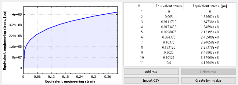

mm. Strain-stress curve of the bar material is defined by the power
law:(1)

The material properties are:
Properties
Value
530 MPa
0.26
Poisson's Ratio
0
Figure 2. Corresponded strain-stress curve

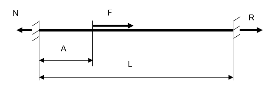

Reference Solution
One-dimensional analytical reference solution is described here.
The length of the bar does not change under the load.(2)
or,(3)
Where,
Tensile strain at the left span of the bar.
Compressive strain at the right span of the bar,
Reaction force at left end of the bar.
Reaction force at the right end of the bar.
Bar cross-section area
From this equation you can find the reaction at the left end of the
bar.(4)
and at the right end.

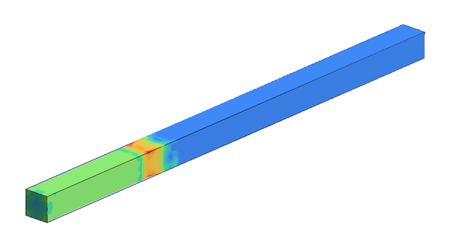

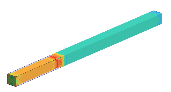

Typical von Mises stress distributions are shown in Figure 4 and Figure 5. The distribution has high gradients at load
application lines; yet the reactions values correlate to the 1D solution because the
reactions are applied far from the active force. Figure 4. von Mises stress distribution at load F=30000
N Figure 5. von Mises stress distribution at load F=60000
