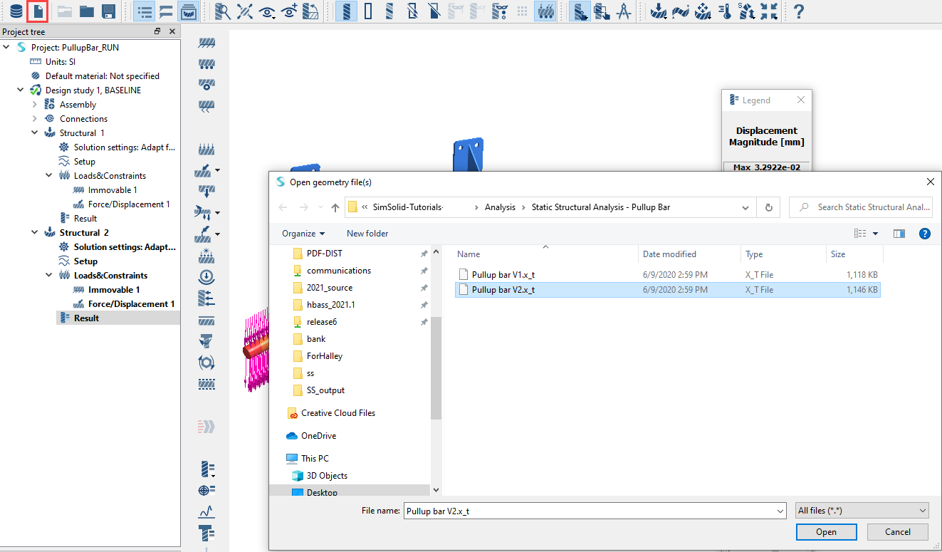

Import Geometry
The new geometry is almost identical to that of Study 1. The only difference is the design of the vertical support brackets. SimSolid instances identical geometry to minimize resources required; this makes the database smaller and the solutions faster.
  1. On the main window toolbar, click Import from file .
  2. In the Open geometry files dialog, choose Pullup bar V2.x_t.
  3. Click Open.
    The new geometry is read into a second design study. All analysis definitions are copied from Study 1 to Study 2. Conflicts and inconsistencies are flagged in red in the Project Tree. This tutorial does not require you to fix geometric inconsistencies.

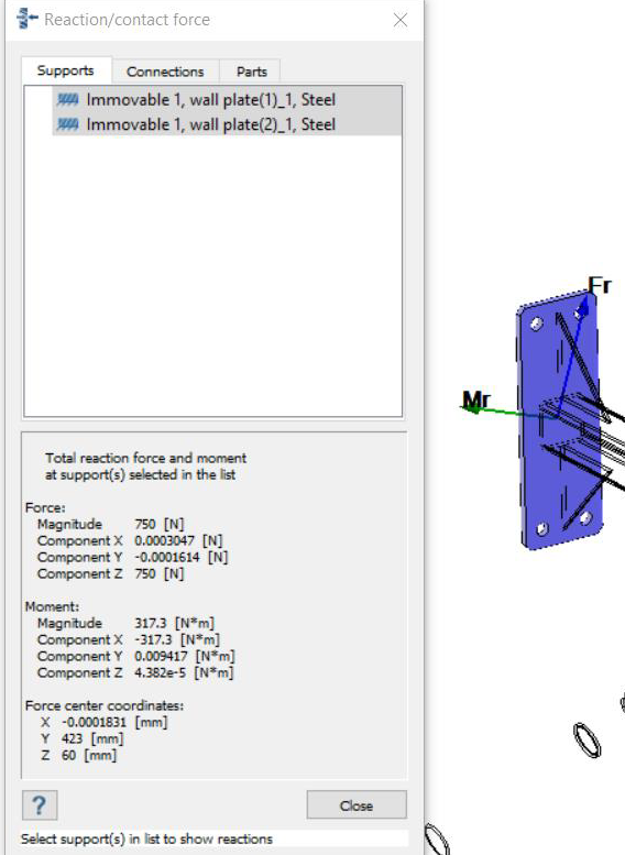

View Reaction Forces
  1. In the Project Tree, open the Analysis Workbench.
  2. In the workbench toolbar, click the (Reaction/contact force) icon.
  3. Click the Supports, Connections, or Parts tab.
    A summary table of the reactions opens. Moment vectors are displayed in the modeling window.
    Figure 4.
  4. Optional: Select a single support, connection, or part to view forces on a single element.
  5. Optional: Select multiple supports, connections, or parts to view a summary of forces.

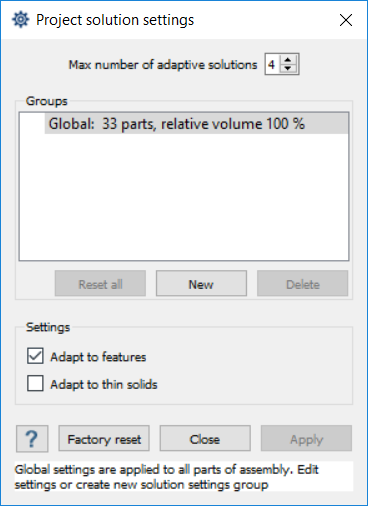

Refine Solution Settings
  1. In the Project Tree, double-click on Solution settings.
  2. In the dialog, increase Max number of adaptive solutions to 4.
  3. Select the Adapt to features check box.
  4. Click OK.

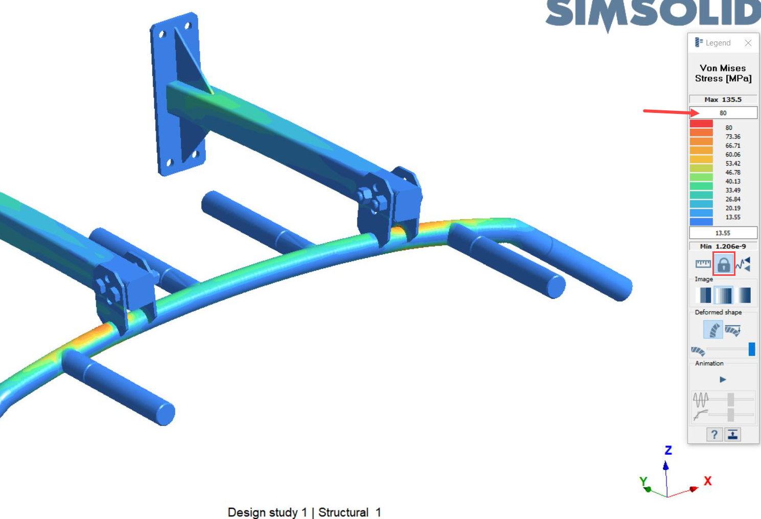

  8. Compare with Pass 3 results.
    1. In the Analysis Workbench, select > Von Mises Stress.
    2. In the Legend, in the box under Max, enter 80.
      This adjusts (locks) the legend to be similar to a 3 pass solution to better highlight peak stress areas.
    3. Click to reset the legend to default values.
