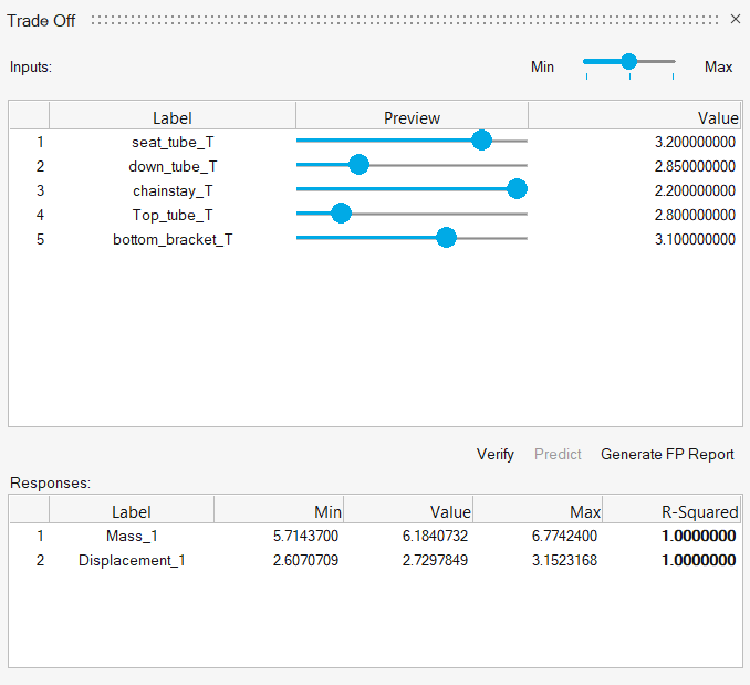

In the Results Explorer browser, click the Trade Off
icon .
In the Inputs area, move the sliders to the desired values, or type values into
the Value column.
Review the predicted response values in the Responses area.

The R-Squared value is a statistical representation of the quality
of a given response fit based on cross validation. R-Squared values
will be color-coded to indicate the level of confidence that should
be attributed to a given fit. The trade-off tool is very useful for
showing trends. It is recommended that a verification run be
performed to validate a predicted response.

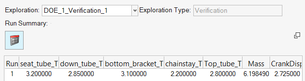

Optional: Click the Verify button, Export,
and Run a verification.
A verification is an exploration where a single solver job is run with the
input design variable values set as they were in the trade-off panel.Figure 2.
Results for the verification exploration run can
be used to verify the predictions. The results can be viewed in the Results
Explorer by setting the verification exploration as the exploration.Figure 3.
