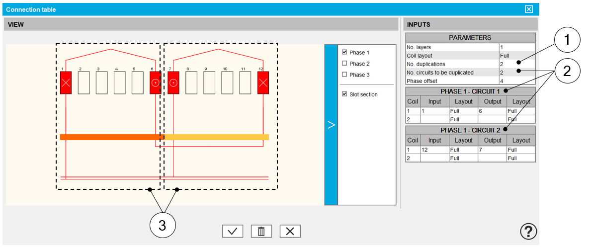

| 4 | Definition of the number of duplications. This number is computed and proposed to the user. It depends on the number of slots and the number of poles. When the winding architecture to build is cut into several identical parts, the corresponding possible number of duplications are proposed (a short list). By selecting the number of duplications, the user must define only 1/n of the connection table. |
| 5 | Number of circuits to be duplicated represent the number of elementary circuits to be defined inside each sector to be duplicated. In this example 2 circuits are defined in the represented sector. This is why, there are 2 connection tables to be filled in. One for each circuit: Phase 1 – Circuit 1 and Phase 1 – Circuit 2 |

| 1 | Dialog box to define a coil with expert mode |
| 2 | The connection table(s) must be filled in. 1 or 2 according to the number of circuits to be represented inside the considered elementary sector.

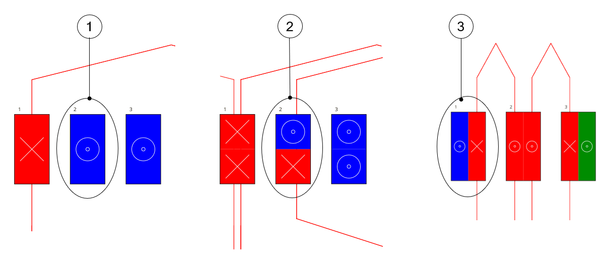

2. Coil layout in slot
| Building the winding architecture – Definition of coil layout | |
| 1 | Example where the coil layout is Full. |
| 2 | Example where the coil layout is Superimposed. |
| 3 | Example where the coil layout is Adjacent. |

| Dialog box for defining the connection table while using the expert mode | |
| 1 | Number of duplications. See the definition in table above. |
| 2 | Number of circuits to be duplicated. See the definition in table above. |
| 3 | Representation of the two circuits inside the considered sector. |

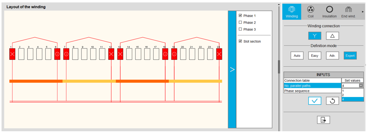

Then, the list of possible number of parallel paths « No. parallel paths » adapts itself in function to the number of duplications « No. duplications » and the number of circuits to be duplicated « No. circuits to be duplicated ».
Here is the resulting layout of the winding architecture below. There are always 4 possible parallel paths. These circuits can be well connected.
| Layout of the resulting winding architecture |
This modification is a problem for motors the number of parallel paths « No. parallel paths » of which is greater to the number of duplications « No. duplications »
In that case, one has decided to modify the value of the « No. parallel paths » to make it take the value of the « No. duplications ».
