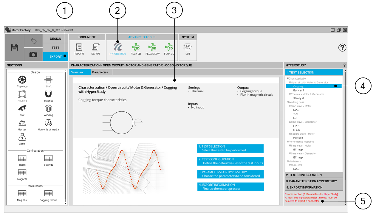

2. Area to build a connector
| Motor Factory – EXPORT AREA – Export connector for HyperStudy® | |
| 1 | Selection of the EXPORT area of Motor Factory. |
| 2 | Access the area in which a connector for HyperStudy® can be made |
| 3 | Zone to visualize either the overview of the selected test or the corresponding user input/output parameters |
| 4 | 4 steps to build the connector to be exported for HyperStudy® |
| 5 | Buttons to validate inputs, display a preview and export the built connector for HyperStudy® |
