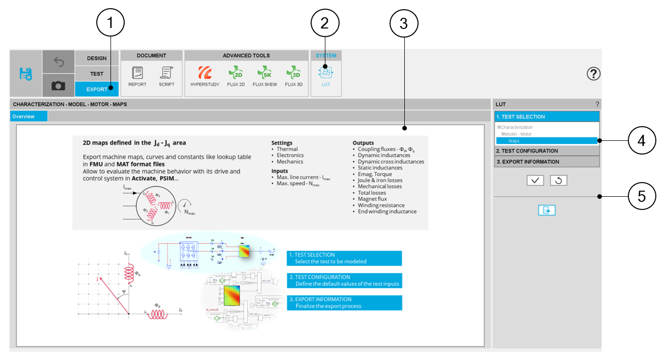

2. Area to export LUT
| Motor Factory – EXPORT AREA – Export data in FMU format files | |
| 1 | Selection of the EXPORT area of Motor Factory. |
| 2 | Access the area (SYSTEM) in which data can be exported in lookup table (LUT) formats. |
| 3 | Zone to visualize either the overview of the selected test |
| 4 | 3 steps to compute and to export LUT data |
| 5 | Button to validate inputs, display a preview and export the data. |

3.2 Test selection
- Characterization / Model / Motor / Maps

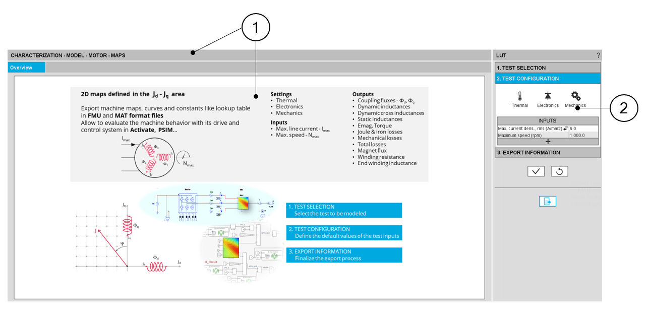

3.3 Test configuration
After selecting a test, the corresponding test inputs (settings and user inputs) must be defined. This allows to define the initial conditions for testing.
| Motor Factory – EXPORT AREA – SYSTEM – LUT / Test configuration for Characterization / Model / Motor / Maps | |
| 1 | Overview of the selected test is displayed. |
| 2 | User inputs can be defined in the test area. |

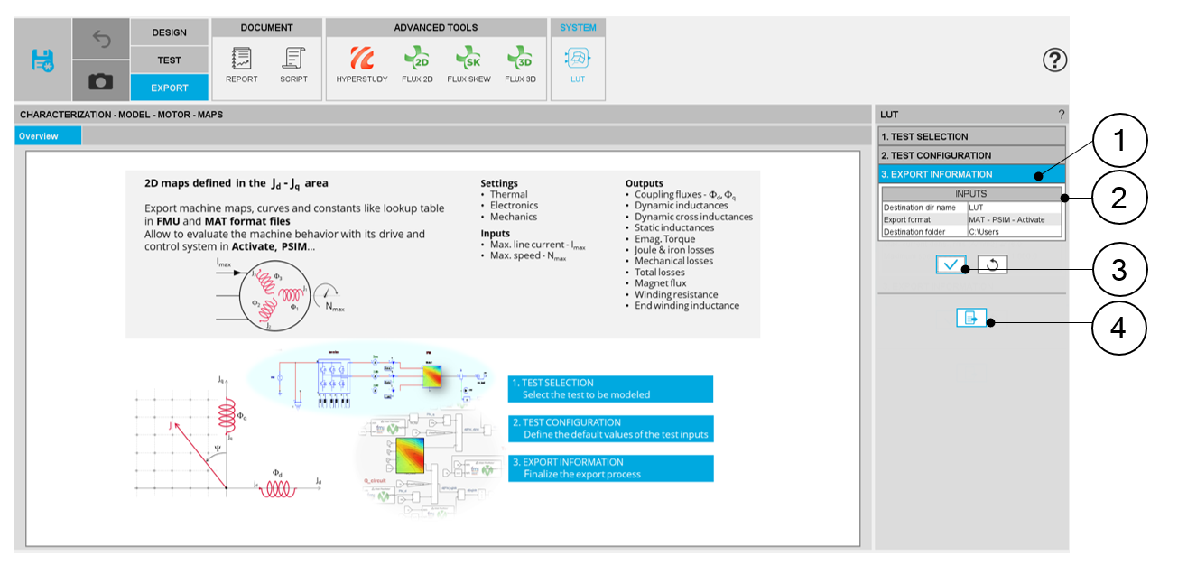

3.4 Export information
The last step for building and exporting data in FMU format files is to define the export information.
- The name of the directory in which the created files will be stored
- The format of the file to be exported. Three options are available: FMU for Activate, FMU generic and MAT file - for Acitvate and PSIM.
- The destination folder in which the previous directory will be located.
| Motor Factory – EXPORT AREA – SYSTEM – LUT / Export information | |
| 1 | Tab to be expanded to define the export information. |
| 2 | Area in which the export information of parameters to be defined are listed |
| 3 | Button to validate the previous choices |
| 4 | Button to finalize the export of the data files. One click opens the folder where the directory is located |
