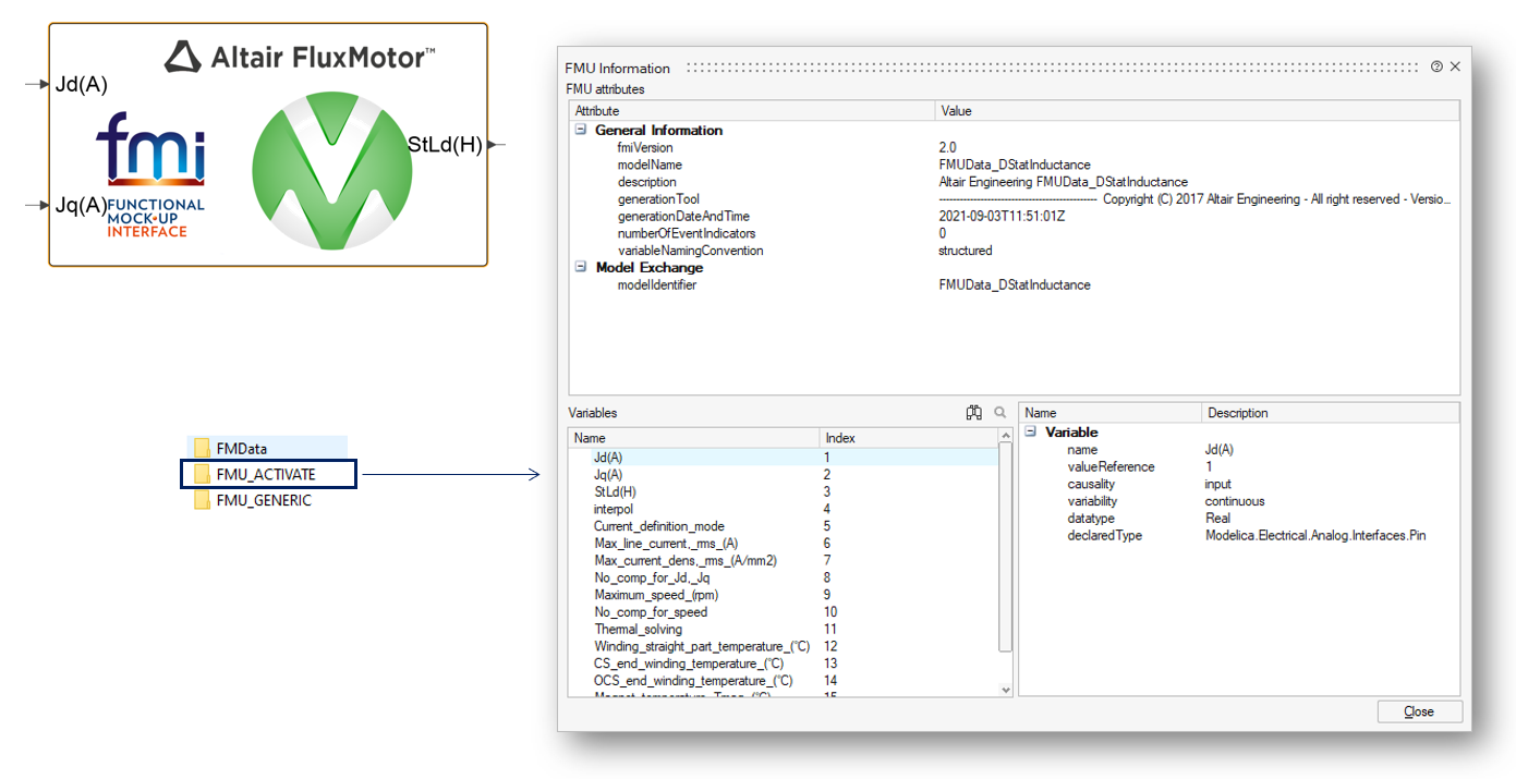

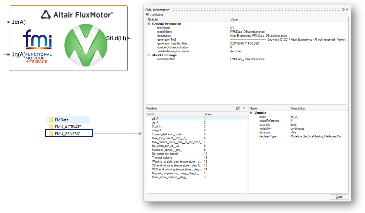

Two packages of FMU format files are automatically provided, one dedicated to Activate® and another one compatible with other system simulation tools.
Hence, the users will be able to select the required system simulation tool without any problem of compatibility. One of the main differences between the two files is how the units are managed in the name labels (See below illustrations).
| Exported FMU format files dedicated to Activate® |
| Exported FMU format files (Generic) compatible with other system simulation tools |

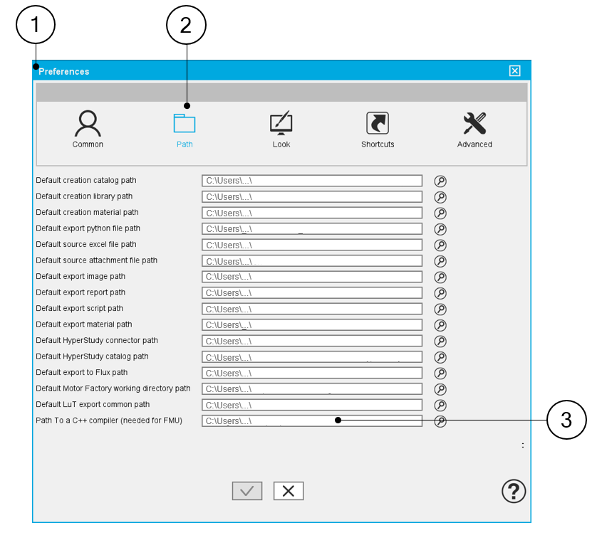

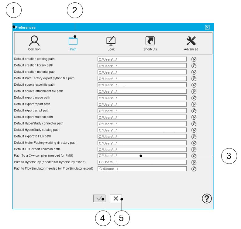

Once the C/C++ Compiler is installed on the computer, its access path must be specified in the user’s preferences.
Note: When opening FluxMotor®, if a C/C++ Compiler is already installed on the computer, the corresponding install path is automatically written in the user’s preferences.
| FluxMotor / Supervisor / User’s preferences / Location of the C/C++ Compiler | |
| 1 | The Preferences dialog box is opened from the FluxMotor® supervisor. |
| 2 | Second tab is Path Preferences. |
| 3 | Define the location of the C/C++ Compiler on the computer |

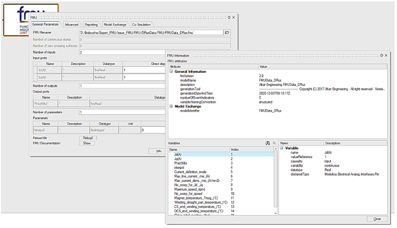

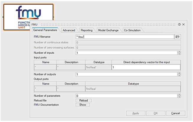

- Double-clickon the FMU dragged in the modeling window, or right-click, and from the
               context menu, select Parameters.
Then:
- In General parameters > FMU filename, indicates the path to the D-axis flux FMU (the directory in which the FMU file is located).
- All the information regarding the D-axis flux FMU appears along with a new content under the name parameters appears.
In this area, you can set the boundaries of the quadrant by choosing a value from 0 to 3.
These boundaries reflect the FMU response when the user is outside the quadrant in which the calculations were made.
The meaning of each value is listed in the table that follows:
| Value | Meaning |
| 0 | NAN |
| 1 | Zero |
| 2 | Hold |
| 3 | Linear extrapolation |
All the information related to the resolution of the test map can be seen by clicking on the info tab.
The FMU generated will have its inputs and output. The D-axis flux FMU in Activate will look like this:
