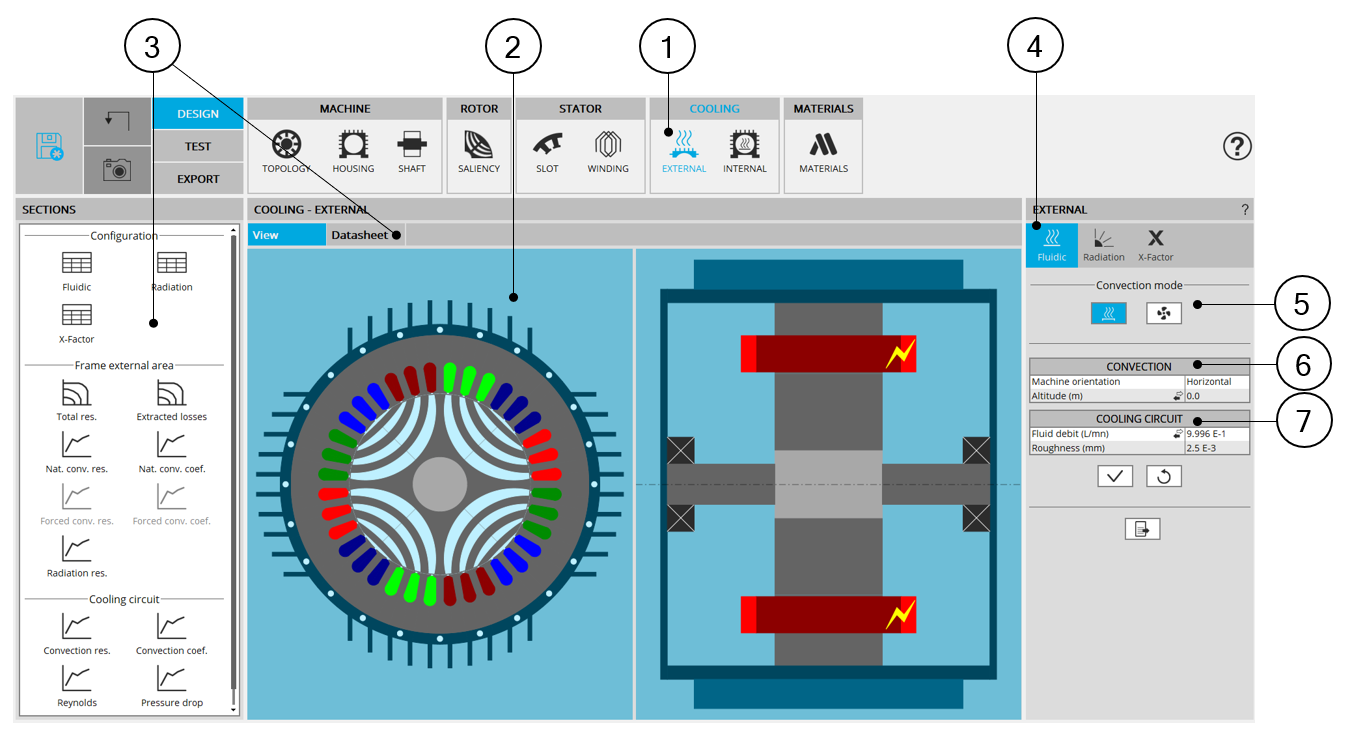

| EXTERNAL COOLING design area - Overview | |
| 1 | Selection of the COOLING subset: EXTERNAL panel (Click on the icon EXTERNAL) |
| 2 | Once the external cooling parameters are defined, corresponding results are automatically displayed in the form of a report. |
| 3 | Visualization of the external cooling characteristics (inputs, and
                        corresponding results) is possible in a datasheet. Scrollbars allow browsing the whole document rapidly and having an overview of all the results. Using scrollbars, complete data can be accessed and visualized. Shortcuts for displaying the corresponding chapter of the external cooling report. |
| 4 | External cooling settings allow describing the external cooling parameters |
| 5 | Choice of the external convection mode: natural or forced |
| 6 | Inputs defining the convection (forced or natural, corresponding to the choice above) |
| 7 | Inputs defining the fluid flow in the cooling circuit. This table is available only when a cooling circuit has been defined by the user in the MACHINE subset, HOUSING panel, CIRCUIT setting. |
