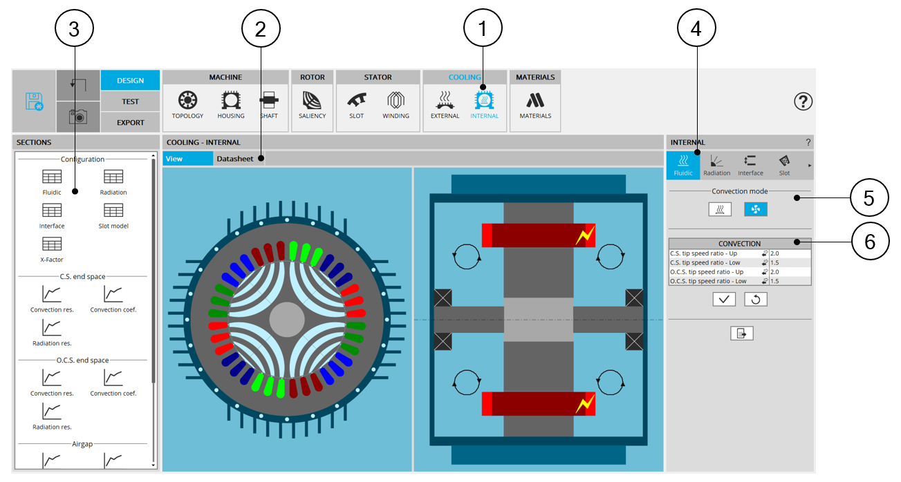

This step allows defining the thermal modeling of the internal cooling, meaning the complex thermal transfers occurring inside the machine.
This panel can be reached only when housing, a shaft and bearings are defined.
- The housing can be defined in the MACHINE subset, HOUSING panel, FRAME settings.
- The shaft can be defined in the MACHINE subset, SHAFT panel, and SHAFT settings.
- Bearings can be defined in the MACHINE subset, SHAFT panel, and BEARING settings.
| INTERNAL COOLING design area - Overview | |
| 1 | Selection of the COOLING subset: INTERNAL panel (Click on the icon INTERNAL) |
| 2 | Once the internal cooling parameters are defined, corresponding results
                        are automatically displayed in form of datasheet. Visualization of the internal cooling characteristics (inputs, and corresponding results) is possible. Scrollbars allow browsing the whole document rapidly and having an overview of all the results. Using scrollbars, complete data can be accessed and visualized. |
| 3 | Shortcuts for displaying the corresponding chapter of the internal cooling datasheet. |
| 4 | Internal cooling settings allow describing the internal cooling parameters. |
| 5 | Choice of the internal convection mode: natural or forced. |
| 6 | Inputs defining the convection (forced or natural, corresponding to the choice above). |
