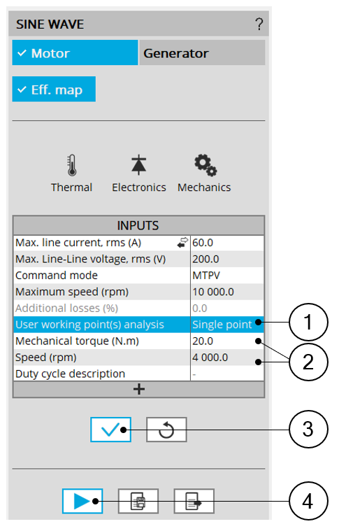

2.8 User working point(s) analysis
It is possible to perform additional analysis on working point(s) located under the torque-speed curve. The user’s input “ User working point(s) analysis ” (additional analysis on working point(s)) gives three possibilities to the user:
               User working point(s) analysis = None (=default mode) This corresponds to the basic configuration of the test, with no additional working point analysis.
               User working point(s) analysis = Single point This allows computing the machine performance on a working point specified by the user with the targeted speed and torque. In that case the next two fields must be filled with the targeted speed and mechanical torque.
 User working point analysis = Single point 1 Select the “Single point” option to perform a computation on one working point. 2 Define the targeted working point mechanical torque and speed. 3 Button to validate and consider the user inputs 4 Button to run the computation

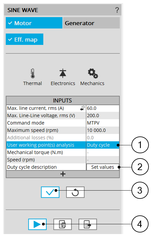

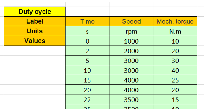

               User working point(s) analysis = Duty cycle This allows computing the machine performance all over a considered duty cycle. This duty cycle must be defined by using the next field: "Duty cycle description" and by clicking on the button "Set values". Two ways are possible to fill in the table: either filling in the table line by line or by importing an excel file which all the working points of the duty cycle are defined.
| User working point analysis = Duty cycle | |
| 1 | Select the “Duty cycle” option |
| 2 | Click in the button “Set values” of the field “Duty cycle” to open a dialog box to define the duty cycle.Refer to the next illustration which shows how to fill the Duty cycle table. |
| 3 | Button to validate the user input data |
| 4 | Button to run the computations |
| User working point analysis = Duty cycle – Dialog box to define the duty cycle | |
| 1 | Dialog box opened after having clicking the button “Set values” in the field “Cycle description” |
| 2 | Browse the folder to select an Excel file which is described the duty cycle |
| 3 | Button to refresh the table data when the considered Excel file has been modified |
| 4 | Fields to be filled with data to describe the duty cycle to be considered |
| Excel file template to define the duty cycle |

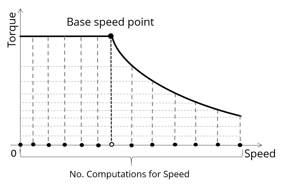

3.2 Number of computations for speed
The “No. comp. for speed” ( Number of computations for speed ) corresponds to the number of points to be considered in the speed range from 0 to the maximum speed.
Half of these points are distributed from 0 to the base speed. The remaining points are distributed from the base speed to the maximum speed.
In both cases, base speed is considered as an additional point.
| Definition of the number of computations for speed |
The default value is equal to 15, the minimum allowed value is 5. The maximum recommended value is 40.

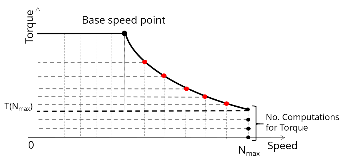

3.3 Number of computations for torque
For the speed range [N base ; N max. ], the number of computations for torque is imposed by the number of computations for speed in the speed range [N base ; N max. ] (Red points in the image shown below).
The advanced user input parameter “ No. comp. for torque ” allows finalizing the grid within the torque range [0, T (N max. )] at the maximum speed (Black points in the image shown below).
The default value is equal to 7. The minimum allowed value is 3. The maximum recommended value is 20.
| Definition of the number of computations for torque – MTPV command mode |
