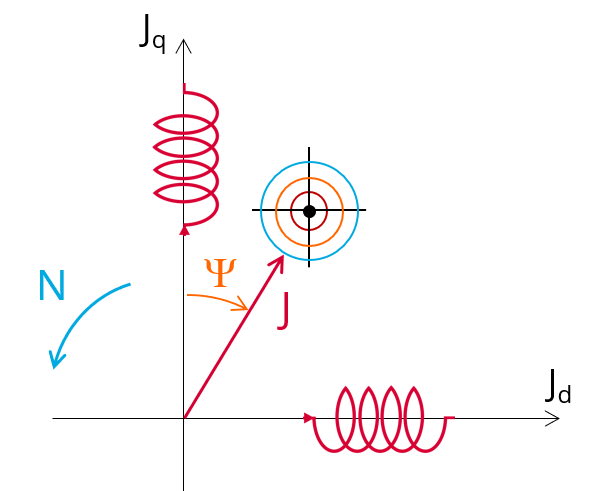

The aim of the test “Mechanics – NVH – Working point – I-Ψ-N” is to perform NVH analysis of the machine when operating at the targeted working point defined with the following inputs values I,Ψ,N (Magnitude of current, Control angle, Speed).
| “Working point – Sine wave – Motor – I, Ψ, N” illustration |
