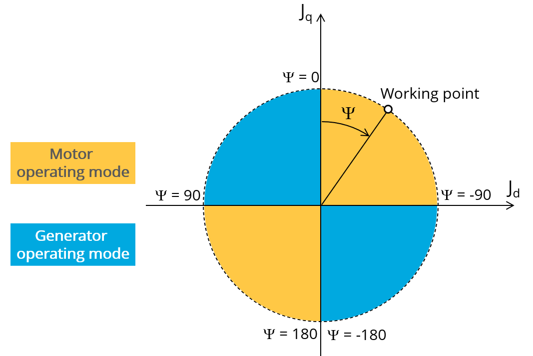

2.2 Control angle
Considering the vector diagram shown below, the “ Control angle ” is the angle between the electromotive force E and the electrical current (J) (Ψ = (E, J)).
The default value is 45 degrees. It is an electrical angle. It must be set in a range of -90 to 90 degrees.
This range of values covers all the possible working point in motor convention.
| Definition of the control angle Ψ - Motor convention |

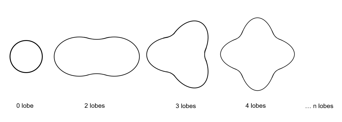

3.2 Maximum mode / spatial order
The “ max. mode / spatial order ” ( Maximum mode / spatial order ) input allows the user to define the number of modes to be considered for the acoustic structural analysis. If the user selects 25, it means that the highest number of lobes in the stator deformation will be equal to 25 lobes. All deformations corresponding to more than 25 lobes will be dismissed.
| Number of lobes of the stator mechanical structure |

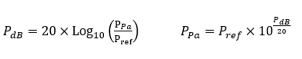

3.4 Displayed pressure range (dB)
The “ displayed pressure range (dB) ” ( Displayed Maxwell pressure range ) is only related to the displaying of results.
It allows to increase / decrease the range of non-zero contributions displayed in the Maxwell pressure harmonic decomposition map.
When one chooses a displayed pressure range equal to 50 dB, only the contributions within the range of 50 dB and below the maximum computed value is displayed.
Considering this referent value P ref , one can compute any Maxwell pressure value P Pa (expressed in Pa) from the ones expressed in Decibel P dB .
The relations between these quantities are illustrated below:
The default value is equal to 60. The range of possible values is [20;100].
