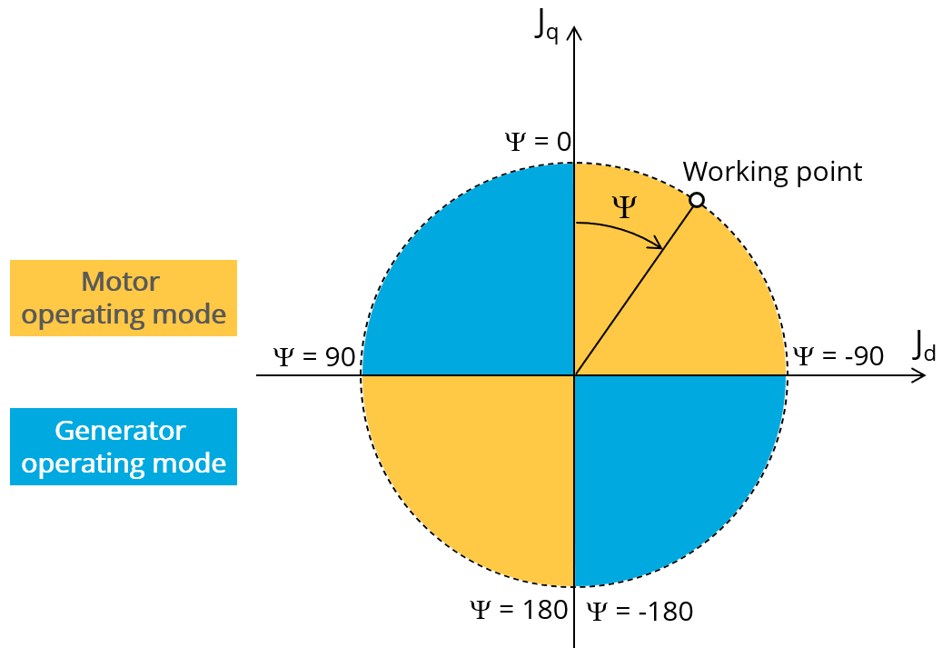

2.3 Control angle
Considering the vector diagram shown below, the “ Control angle ” is the angle between the electromotive force E and the electrical current (J) (Ψ = (E, J)). It is an electrical angle. It must be set in a range of -90 to 90 degrees.
This range of values covers all the possible working point in motor convention.
| Definition of the control angle Ψ - Motor convention |

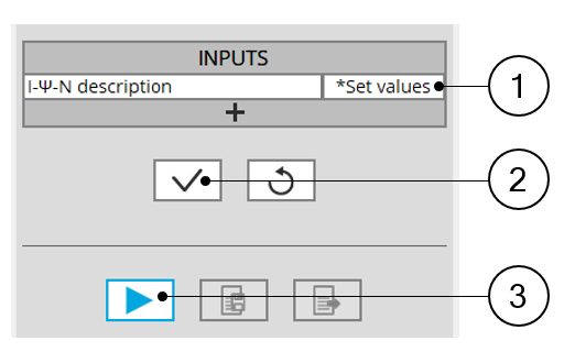

2.5 Process to define the list of working points
| List of working points to be defined | |
| 1 | Click on the button “Set values” of the field “ I, Ψ, N description” to define the working points in a dialog box. Refer to the next illustration which shows how to fill the working point table. |
| 2 | Button to validate the user input data |
| 3 | Button to run the computations |

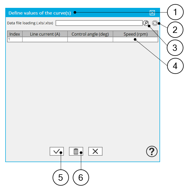

| Dialog box to define the list of working points | |
| 1 | Dialog box opened after having clicked on the button “Set values” in the field “Cycle description” |
| 2 | Browse the folder to select an Excel file which is described the duty cycle |
| 3 | Button to refresh the table data when the considered Excel file has been modified |
| 4 | Fields to be filled with data to describe the duty cycle to be considered |

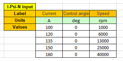

| Excel file template to define the list of working points |

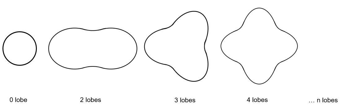

3.2 Maximum mode / spatial order
The “ max. mode / spatial order ” ( Maximum mode / spatial order ) input allows the user to define the number of modes to be considered for the acoustic structural analysis. If the user selects 25, it means that the highest number of lobes in the stator deformation will be equal to 25 lobes. All deformations corresponding to more than 25 lobes will be dismissed.
| Number of lobes of the stator mechanical structure |
