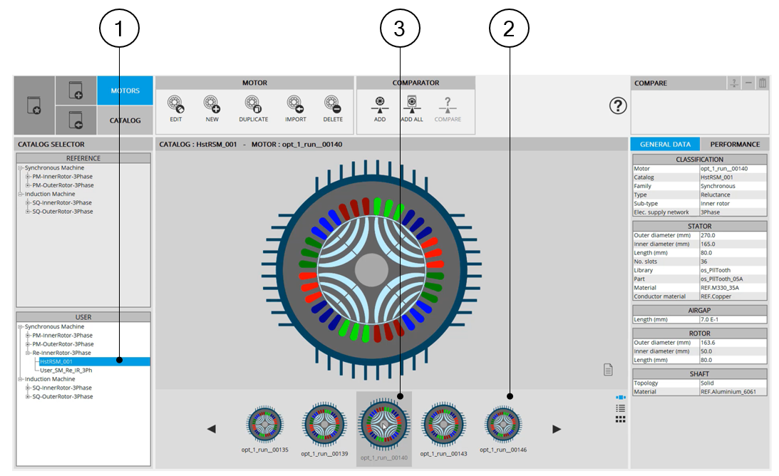

All the motors resulting from the operations performed with Altair® HyperStudy® can be used back in Motor Catalog of Altair® FluxMotor®, and then these can be edited in Motor Factory very quickly.
| Motor Catalog – Visualization of results got from HyperStudy® | |
| 1 | A catalog is automatically built by using the name of the connector defined by the user |
| 2 | All the operations performed with HyperStudy® are stored in the dedicated catalog |
| 3 | Each motor can be selected, visualized and edited in the Motor Factory, to be evaluated more in depth |
