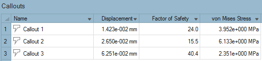

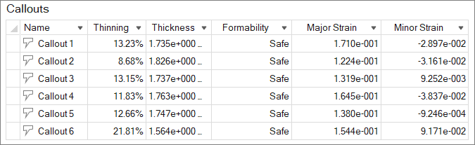

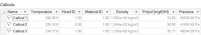

List Callouts
Display in a table all of the callouts that have been created, with the result types and values. Each callout is specific to the selected run and load caseand operation.
  • Click the icon to show/hide the callout in the modeling window.
  • Select a row to select the callout in the modeling window.
  • Click a column header to sort the column. Click to toggle between ascending and descending order.
  • Right-click a column header to change the result type that is shown, and to sort the order of the columns.
