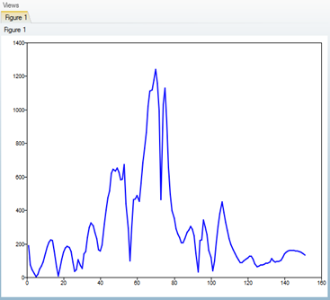

x=[1:151];
y=readvector('<installation_directory>/tutorials/ANGACC','Angular
Acceleration','50th% Hybrid3 - LOWER TORSO','Res. ang. acc.');
plot(x,y);

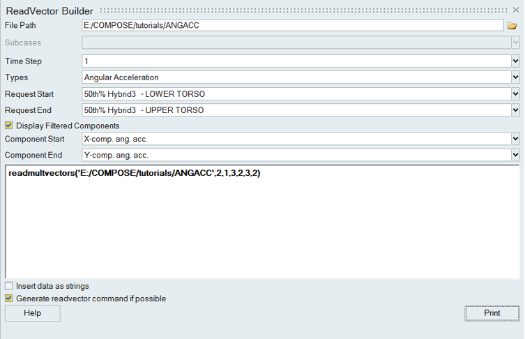

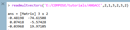

In this case, the first time step is selected and multiple requests and components are selected

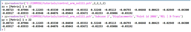

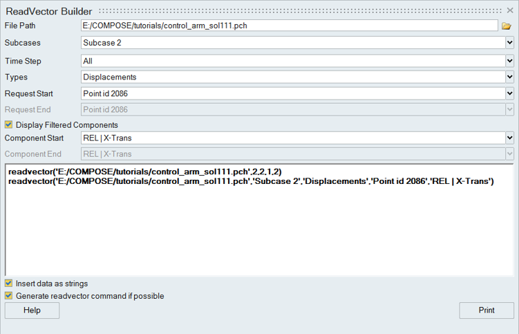

Example 3
In this example, subcases are available in the data file. Subcase 2 is selected. For Time Step, All is selected. One node, for example, 'Point id 2086', is picked, and the 'REL | X-Trans' -displacement is queried. The Generate readvector command if possible check box is selected.
Figure 5.
In Compose, these commands extract the displacement along 'REL | X-Trans' of node 'Point id 2086' in the second subcase of this result file:

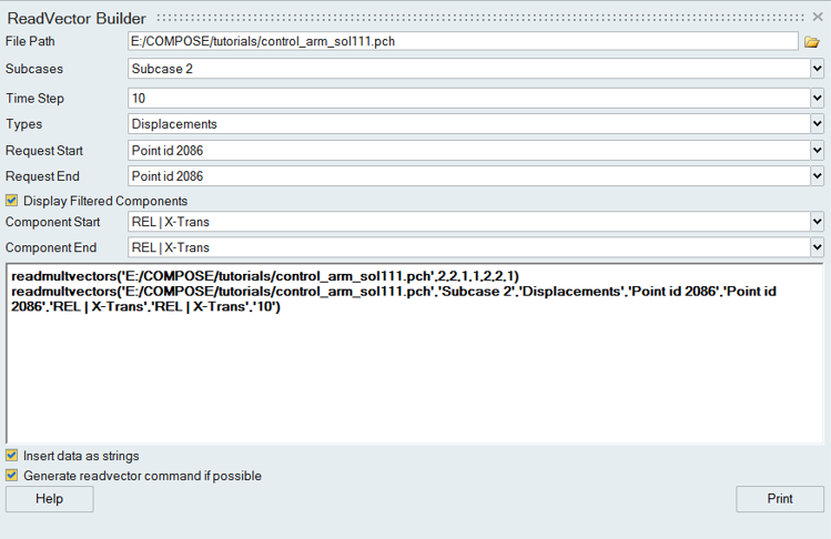

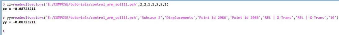

Example 4
In this example, subcases are available in the data file. Subcase 2 is selected, as is Single time Steps. One node, for example, 'Point id 2086', is picked and the 'REL | X-Trans' -displacement is queried. The Generate readvector command if possible check box is selected.
Figure 7.
In Compose, these commands extract the displacement along 'REL | X-Trans' of node 'Point id 2086' in the second subcase of this result file for single time step:

The readvectorbuilder utility contains the following fields:
- FilePath: Type in or open a file browser to select a CAE result file. All files supported by the CAE readers available in Compose can be read.
- Subcases: For the selected file, all subcases (if any) contained in the file are listed.
- Time Step: For the selected file, all time steps (if any) contained in the file are listed.
- Types: For the selected file, all types (if any) contained in the file are listed.
- Request Start: For the selected file, all requests contained in the file are listed.
- Request End: If the selection allows for selecting a range of requests, all requests contained in the file are listed.

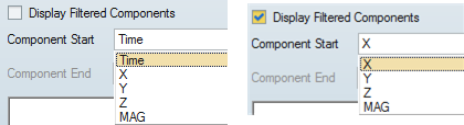

- Display Filtered Components: Used to filter true components. Some files list additional components (mostly Time), but those are not applicable. They can be filtered out.
Figure 9.
- Component Start: For the selected file, all requests contained in the file are listed.
- Component End: If the selection allows for selecting a range of components, all components contained in the file are listed.
- Insert data as strings: By default, the readvector() and readmultvectors() commands generated by this utility use strings. Uncheck this check box to use integer indices.
- Help: Access to this help page.
- Print: After selecting items in the different fields, press Print to display the Compose command in the edition area (supports copy, paste, clear).
- Generate readvector command if possible: Be default, a readmultvectors() command is generated. However, if you activate this option, along with all time steps, it is possible to generate a readvector command.
