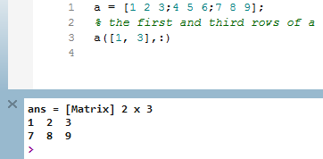

To slice several rows or columns from that matrix, use an array to specify the
rows or columns:
a = [1 2 3;4 5 6;7 8 9]; % the first and third rows of a a([1, 3],:)This extracts the first and third rows of the matrix
a:

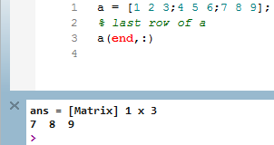

When slicing a matrix,
endstands for the last index of a row or column.a = [1 2 3;4 5 6;7 8 9]; a(end,:)This returns the last row of matrix
a:

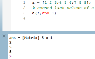

a = [1 2 3;4 5 6;7 8 9]; a(:,end-1)This script returns thesecond last column of a:

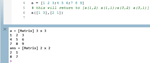

If you want to extract specific elements in a matrix, use two arrays to specify
the rows and columns being referenced, respectively. For example:
a = [1 2 3;4 5 6;7 8 9]; a([1 3],[2 1])[1 3] stands for the first and third rows, [2 1] stands for the second and first column:

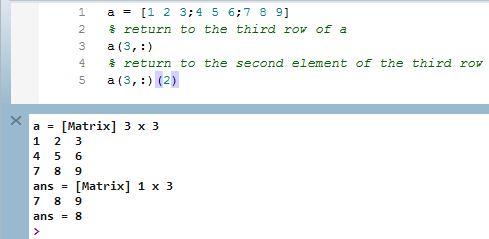

Assignment operations can be joined. Below is an example to extract an element
from a sliced matrix:
a = [1 2 3;4 5 6;7 8 9] % return to the third row of a a(3,:) % return to the second element of the third row a(3,:)(2)
