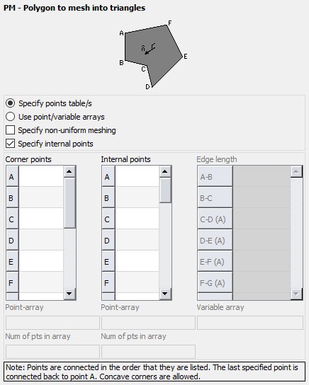

Figure 1. The PM - Polygon to mesh into triangles dialog.
Parameters:
- Specify points table/s
- This option allows data entry in a table with a maximum of 13 points.
- Use point/variable arrays
- This option allows data entry using arrays without a limit on the number of corner points.
- Specify non-uniform meshing
- Check this item to enable the table in which edge lengths for each edge can be entered.
- Specify internal points
- Check this item to enable the table in which internal points can be specified.
- Corner points
- Enter the points, previously defined with the DP card. The points can be entered in the rows or as point (node name) arrays.
- Internal points
- Any points internal to the structure where mesh points are required can be entered here. This is particularly useful for the connection points between surfaces and wires. The points can be entered in the rows or as point (node name) arrays.
- Edge length
- The mesh length on each edge can be set separately in this table. The edge lengths can be entered in the rows or as variable arrays. When using the table entry, any blank entries in this table will be meshed with the parameters set in the IP card. There may not be more entries in this table than in the first one. When using the array entry method, the variable array has to be the same length as the corner point array.
