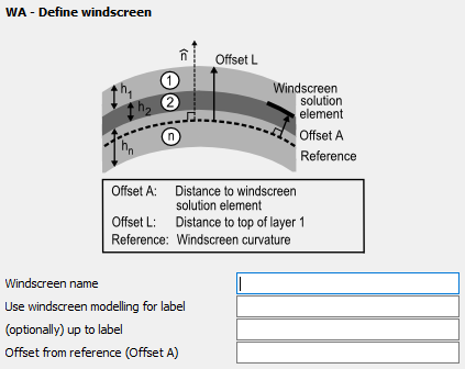

On the Solve/Run tab, in the Windscreen
group, click the
Windscreen element (WA) icon.
Figure 1. The WA - Define windscreen dialog.
Parameters:
- Windscreen name
- Name of the windscreen.
- Use windscreen modelling for label
- Start of the label range.
- (optionally) up to label
- [Optional] End of the label range.
- Offset from reference (Offset A)
- Offset of the specified label geometry with respect to the reference windscreen triangles.
The antenna elements will be limited to lying tangentially with respect to the windscreen surface. Using a defined offset from the reference plane (in the direction of the reference plane normal), these elements can then be positioned at the exact required location. This offset is specifically needed because of the limitations of a finite mesh (compared to a smooth surface) in combination with curvature in the model.
