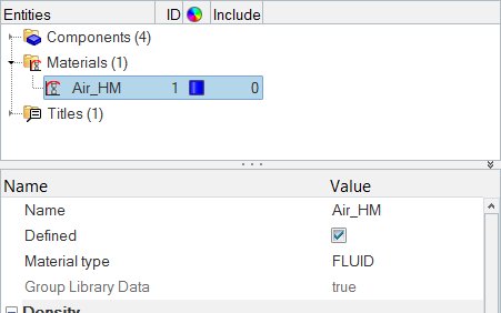

  1. Create the material, Air_HM.
    1. In the Model Browser, right-click and select Create > Material from the context menu.
      A new material opens in the Entity Editor.
    2. For Name, enter Air_HM.
    3. Set Material type to FLUID.

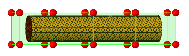

  1. In the panel area, click HyperMorph > morph volumes.

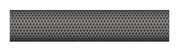

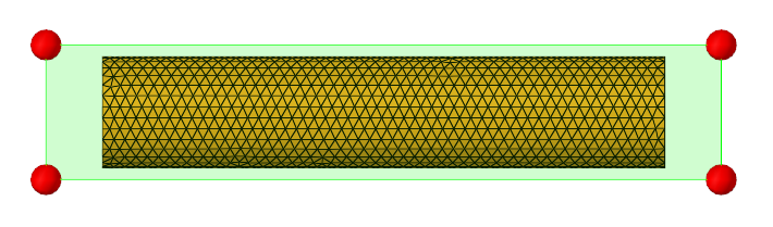

  2. Create morph volume.
    1. Go to the create subpanel.
    2. Click elems (yellow entity selector) > all.
      All of the elements in the model are selected.
      Figure 5. Selected Elements
    3. Click create.
      Figure 6. Morph Volume

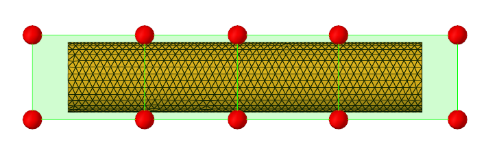

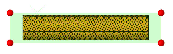

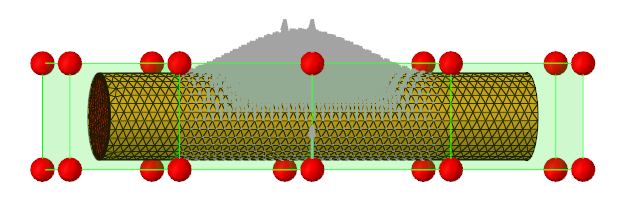

  3. Split morph volume.
    1. Go to the split/combine subpanel.
    2. In the graphics area, double-click on the edge of the model that is marked by a green cross in Figure 7.
      Figure 7. Morph Volume Split Edge
    3. Click split.

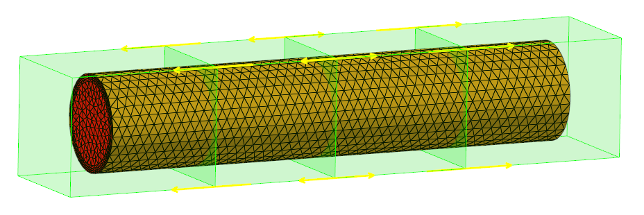

  4. Continue splitting the morph volume so that it resembles Figure 8.
    Figure 8. Morph Volume Split
  5. Update ends.
    1. Go to the update edges subpanel.
    2. Click the first arrow and select update ends.
    3. Click the third arrow and select main-secondary.
      Note: This options allows you to link any two edges together with a “main-secondary” relationship between two morph volumes.
    4. Define the main edge by clicking the first edge of the morph volume.
    5. Define the secondary edge by clicking the edge that touches the main edge.
  6. Repeat steps 5.d and 5.e for all of the edges until your model resembles the following image.
    Note: Verify that the yellow arrows are pointing in the correct direction along the edges.
    Figure 9. Updated Main-secondary Ends

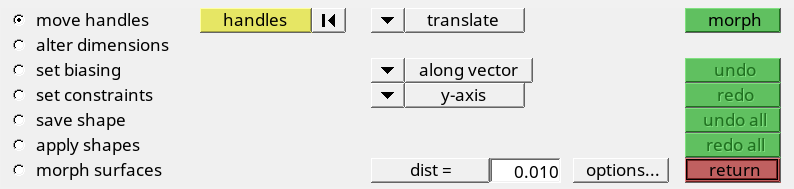

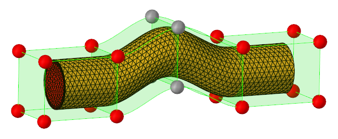

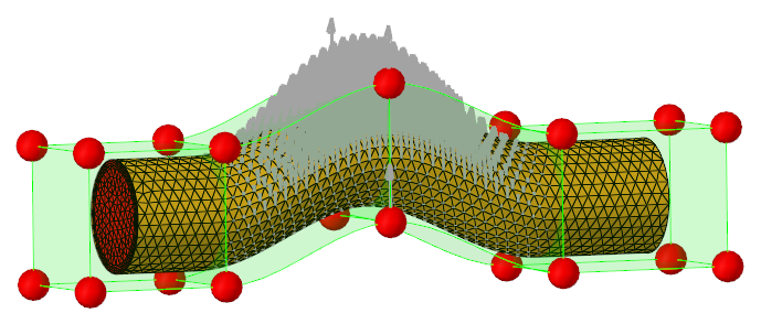

  8. Morph the model.
    1. In the panel area, click morph.
    2. Go to the move handles subpanel.
    3. Click the second arrow and select translate.
    4. Under translate, click the arrow and select along vector.
    5. Under along vector, set the orientation selector to y-axis.
    6. In the dist = field, enter 0.010.
      Figure 10. Settings for Move Handles Subpanel

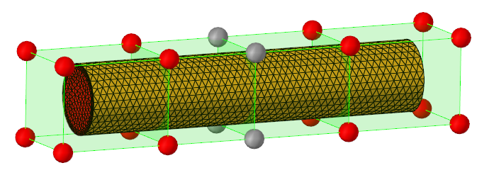

    7. Click the handles selector.
    8. Select the four middle handles, highlighted in grey, in Figure 11.
      Figure 11. Middle Handles Selected
    9. Click morph.
      The grid is morphed.
      Figure 12. Morphed Grid

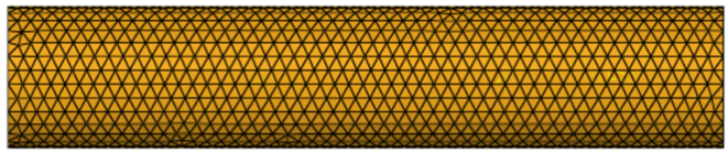

  9. Save shape.
    1. Go to the save shape subpanel.
    2. In the name= field, enter s1.
    3. Switch the first toggle from as handle perturbations to as node perturbations.
    4. Click save.
    5. In the window that appears, click Yes.
      Perturbations for nodes at global and morph volume handles are saved.
    6. Click undo all.
    Figure 13. Saved Shape

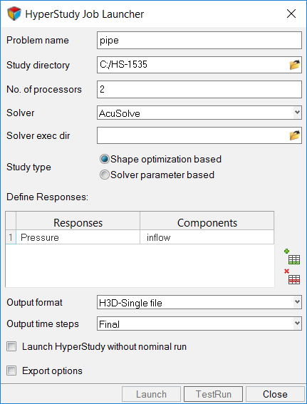

Perform Study with HyperStudy Job Launcher
  1. On the CFD toolbar, click .
  2. In the HyperStudy Job Launcher, set up and launch the HyperStudy job.
    1. In the Study directory field, navigate to the location of your working directory.
      Tip: By default path will be the same directory in which the .hm file is saved. It is recommended that you create a separate folder for your study directory so that all of the files will be placed in that folder.
    2. In the No. of processors field, enter 2.
    3. In the Define Responses table, identify what the pressure change will be at inflow due to shape changes by setting Responses to Pressure and Components to inflow.
    4. Set Output format to H3D-Single file.
      Selecting H3D-Single file enables you to see how the pressure contours for each optimum design will look.
    5. Click Launch.
    Figure 16. HyperStudy Job Launcher

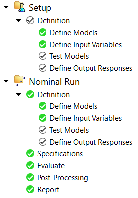

    A nominal run is submitted, and acuProbe and acuTrail are launched to provide you with updated information about the run. Once the run is finished, HyperStudy opens and with the study setup completed.
    Figure 17. Study Setup
  4. Go through each step to ensure that everything was properly defined.
  5. Go to the Setup > Definition > Define Models step and verify that the resource file, solver input file, and solver execution script have been defined.
  6. Go to the Setup > Definition > Define Input Variables step and verify that the input variable you defined in HyperMesh Desktop has been imported.
  7. Go to the Setup > Definition > Define Output Responses step and verify that the output response is defined correctly.

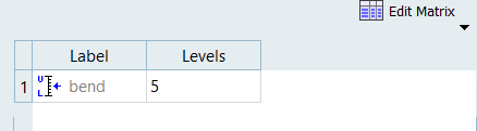

  3. In the work area, set the Mode to Full Factorial.
  4. Click the Levels tab.
  5. For bend, change Levels to 5.
    Figure 18.
  6. Click Apply.

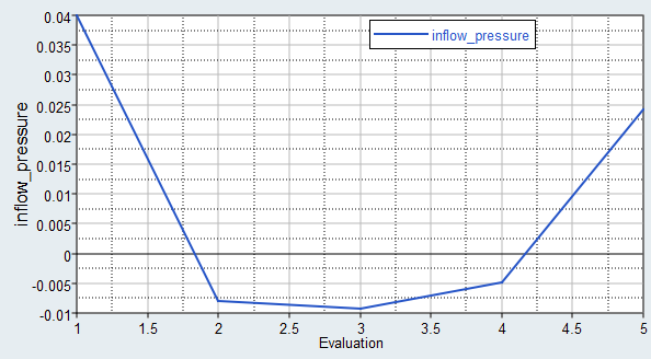

  10. Plot the results of the inflow_pressure output response of the five runs.
    1. Click the Evaluation Plot tab.
    2. Using the Channel selector, select inflow_pressure.
    Figure 19. Evaluation Plot

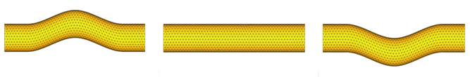

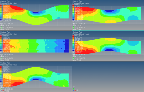

    The extreme left (bend = -1), middle (bend = 0) and extreme right (bend = 1) results correspond to the pipe shapes shown in Figure 20.
    Figure 20. Pipe Shapes

  12. The results of the DOE can be visualized by loading the corresponding *.h3d file from the run folder into HyperView.
    Figure 21. Contour Plot of DOE Results
