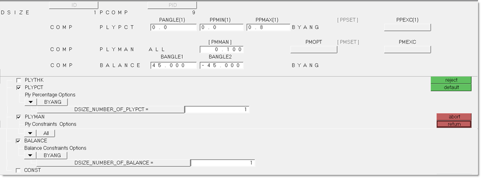

- Ply percentage for the 0s no more than 80% exist.

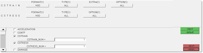

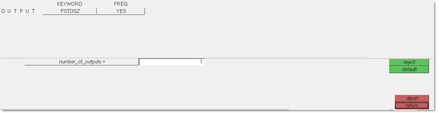

Define the Output Request

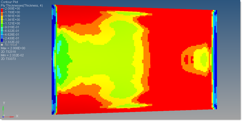

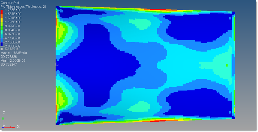

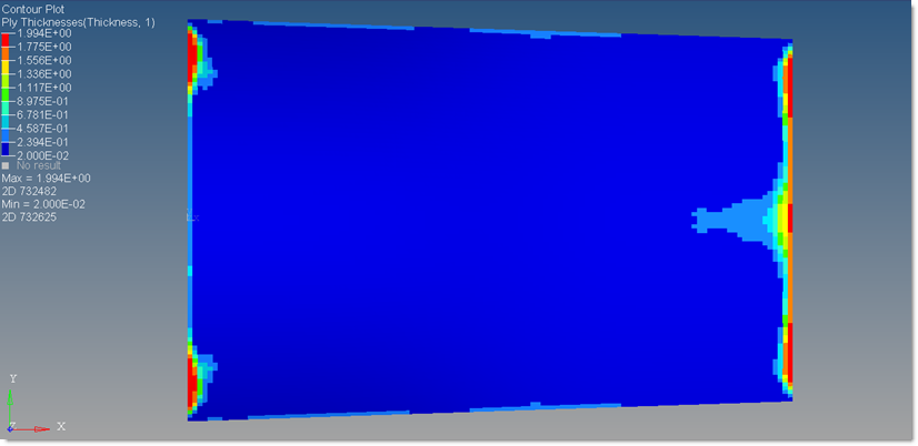

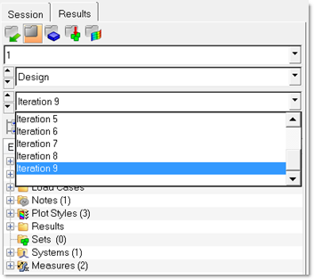

View the Results

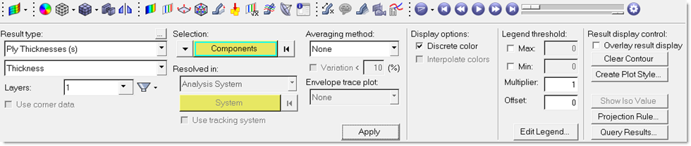

View the Element Thickness Results
Figure 5. Element Thicknesses Contour Plot after Free-size Optimization
to open the
to view the results in the X-Y plane.
