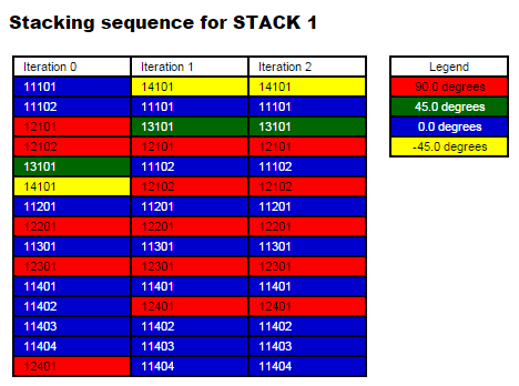

- oht_opti_ph3.shuf.html
- An HTML file contains the history of the shuffling optimization and the view of the ply stacking sequence.
Post-process Results
The plies are color coded based on their fiber orientations. The columns represent the global trend of the ply stacking sequence at a particular iteration, with the last column being the final solution.
The weight of the part has not been changed during the shuffling design phase, rather the plies were reordered to obtain the maximum performance.
Figure 1. Shuffling Optimization History
