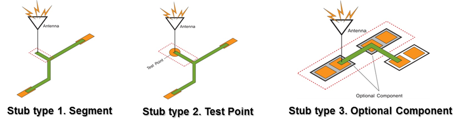

Stubs may not affect the signal path among pins, but they could act as antenna and cause EMI problems. If a stub is longer than a certain length, it becomes a good antenna, so you should avoid long stubs in designs. Some types of stubs have no purpose at all from a design point of view. However, a certain type of stub has an intended purpose. One of such examples is a test point. If a pattern is branched to make a test point, this structure can act as an antenna. Another is an optional component. You can route to a resistor point, but if a manufacturing engineer does not use resistor, the rest of pattern can act as an antenna. This stub rule checks unnecessary stubs for those three cases mentioned above.

- Some types of stubs have no purpose at all in design point of view.

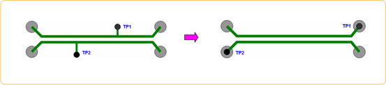

- However, a certain type of stub has an intended purpose. One of such examples is a test point. If a pattern is branched to make a test point, this structure act as an antenna.
- Another is an optional component. Board designer may route to a resistor
point, but if a manufacturing engineer does not use the resistor, the rest
of the pattern can be act as an antenna.

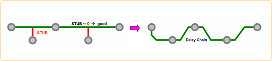

Trace stubs should be minimized if absolutely required or eliminated if not.
A stub encounters an impedance mismatch at the high-impedance input of the receiver, causing reflections.
The loss of energy resulting from a reflection causes attenuation of the signal as it proceeds to its destination. The reflection itself can result in ringing and jitter as it collides with other signals being generated by the source.
