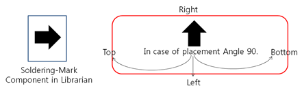

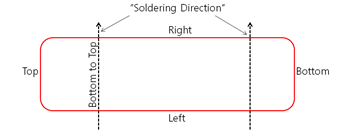

- Board Direction Definition: Decide the board's placement status using the
soldering mark or by defining the soldering direction.
- Soldering-Mark Component Group: Define the soldering mark. Use if it is registered as a group of components.
- Mark Direction: Define the mark’s direction and the soldering
direction.
Figure 1. - Soldering Direction: Define the direction of the board without using
soldering-mark case.
