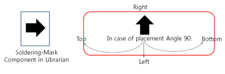

- Soldering-Mark Component Group: If the soldering-mark is registered
as components, define it.
- Mark Direction: To define the real soldering direction,
define the mark direction.
Figure 1. Mark Direction Example

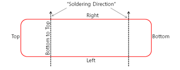

- Soldering Direction: Not using soldering-mark case, define the
direction of the board.
Figure 2. Soldering Direction Example
