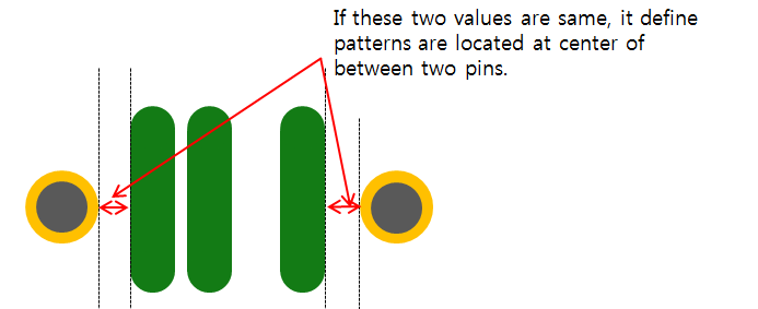

- CL (Center Line): Check whether patterns between two pins are
located in exact center of two pins.
Figure 1. - SNE (Same Net Exception): Among patterns, if routing patterns are connected to target pins, they will be excluded in checking.
