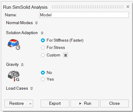

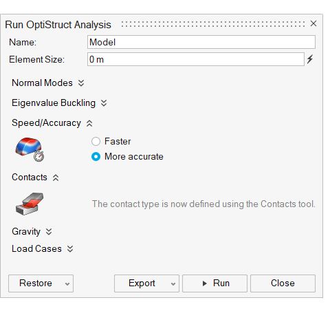

  3. Select the Run Analysis tool on the Analyze icon to define settings for the analysis.
    The options will vary based on whether you are running a SimSolid or OptiStruct analysis. Linear static analysis is run automatically, and you can choose whether to run a normal modes analysis. If running an OptiStruct analysis, buckling modes are available as well.
    Run SimSolid Analysis Run OptiStruct Analysis

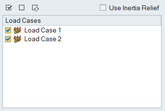

  4. If you have created multiple load cases, click the button next to Load cases and then select the checkbox next to each load case you want to analyze. Each load case will produce a different result.

Element Size (OptiStruct)
The element size dictates the quality of your optimization results. In general, the smaller the element size, the more accurate the result, but the slower it will run.
Note: To improve overall performance, when a CAD file is imported the mesh sizes are not calculated and are shown as Auto. Click the icon to display the Element Size.
The element size is calculated from the smallest features in the CAD. Cleaning up the CAD so there are fewer features will help jobs to run faster.

Solution Adaption (SimSolid)
SimSolid provides three solution adaption objectives to control solution accuracy.
  • Select For Stiffness (Faster) for general load path prediction and modes. This uses three adaptive solution passes and is typically the fastest solution method.
  • Select For Stress for more detailed stress calculation. This uses four adaptive passes and activates additional logic to more accurately refine the solution in areas of high stress.
  • Select Custom to choose your own custom settings in the Preferences.
Speed/Accuracy (OptiStruct)
Select Faster when stresses are not a major concern and testing your model to ensure that the kenamatics of your loads and supports are correct. If you need more accurate results, select More accurate and rerun the analysis to achieve more precise stress and displacement results. This will also increase the run time.

Load Cases
A load case is a set of loads and supports that act on a model at one time. You can assign loads and supports to specific load cases using the Model Browser or context menu. Then when you run an analysis, you choose which load cases to include in the Run Analysis window.

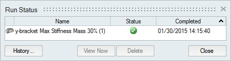

Run Status
View the status of the current run, as well runs for the current model that have not yet been viewed. To see all past runs, you need to view the run history.
  1. Hover over the Analyze icon, then select the Run Status tool.
    The run status window is displayed.
  2. When the run is complete, review its status.
    Status Description Note
    The run completed successfully. This is also indicated by a green flag above the Analyze icon. You can click the green flag to display the results.
    The run was incomplete.
    If running an analysis, the run was incomplete. Some but not all of the result types may be available. You should run a new analysis to generate complete results.
    If running an optimization, the run was completed but with warnings or violations. Double-click the name of the run in the Run Status dialog, and then click the Design Violations button in the Shape Explorer for more information.
    The run failed and no meaningful results are available. This is also indicated by a red flag above the Analyze icon.
  3. View one or more runs.
    • To view a run, double-click the row.
    • To view multiple runs, hold down Ctrl or Shift while clicking the rows, and then click the View Now button.
      Note: If several runs are associated with the same part, the result from the most recently completed run for that part will be activated in the modeling window.

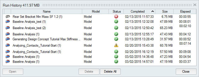

Run History
View, sort, open, and delete past runs for the current and previous models.
Once you have viewed an analysis run, it is removed from the Run Status window but can be viewed using the Run History table.
  1. Hover over the Analyze or Analyze CFD icon, then select the Run Status tool.
    The run history is displayed.
  2. Review the status of the run.
  3. To view a run, double-click the row.
Tip:
  • To open the directory where a run is stored, right-click the run name and select Open Run Folder. The default directory where the run history is stored can be changed in the Preferences under Run Options.
  • By default, you will receive a notification when the run history exceeds a certain size. You can change the size limit or turn off the notification in the Preferences under Run Options.
  • To delete a run, select the run and press Delete.
