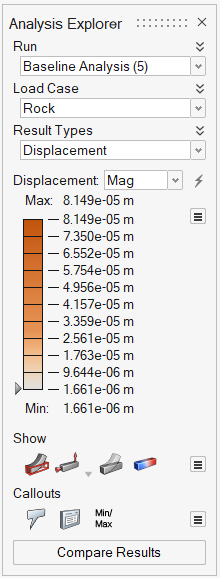

Click the Show Analysis Results tool on the
Analyze icon to open the Analysis Explorer.
- Select the Run you want to view.
- Select a Load Case.
- Select a Result Type. The result is displayed in the modeling window.
- Use the additional options to animate the result, change what is shown in the modeling view, create callouts, and compare results.
- Right-click or press Esc to close the Analysis Explorer and return to the original part.

Run
To delete a run from the Analysis Explorer, right-click the run name to select Delete Run.
Load Case
The Result Envelope is created when you have two or more static load cases. It shows the maximum value for each result type across all load cases.
Result Types
Modes
All physical objects have frequencies at which they vibrate that are called normal modes. If you chose to run a normal modes analysis in the Run Analysis window, the modes will be listed here when you select Normal Modes for the Load Case. Click on a mode to view the displacement for that mode.

Results Slider
- To change the upper or lower bound for the results slider, click on the
bound and enter a new value. Click the reset
button to restore the default values. - To filter the results so that areas on the model with results greater than a
specified value are masked, click and drag the arrow on the results slider.

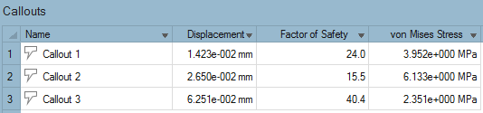

| List Callouts |
Display in a table all of the callouts that have been created, with
the result types and values. Each callout is specific to the selected
run and load case.![]() |
