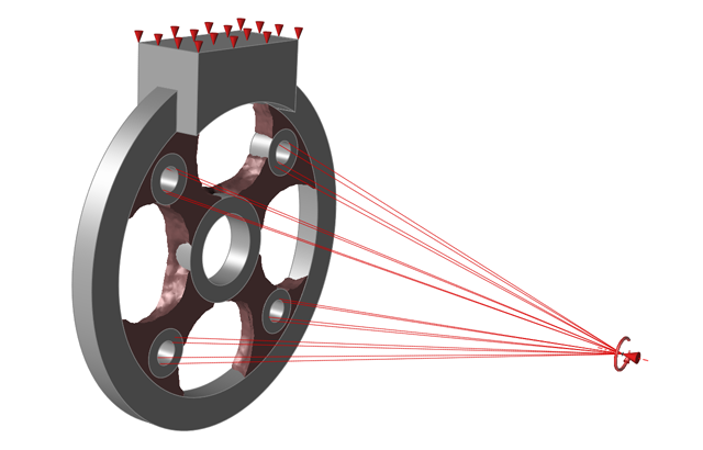

Place Supports at a Distance
Move a support away from the model to create a support at a distance.

Translate or rotate the support using the Move tool. Use to place a support at a distance. |
