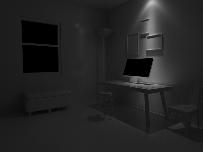

Create an IES Light
To create an IES light, you need an IES file, which is a digital profile of an existing light. IES lights are useful to simulate physically accurate lights.
            Figure 1. Example of an IES Light with an ISO of 200Turn on the Materials display mode, so you can see the changes as they are applied.
You may want to decrease the intensity of the global environment if you plan to add lights to your scene.
