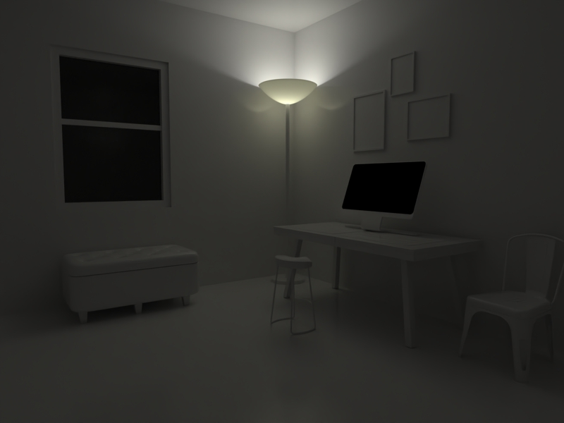

A point light radiates light in all directions, and is useful for generating soft shadows. Common examples include light bulbs and candles.
            Figure 1. Example of a Point Light with an ISO of 200You may want to decrease the Intensity of the global environment if you plan to add lights to your scene.

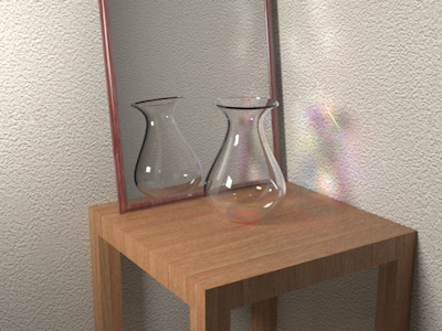

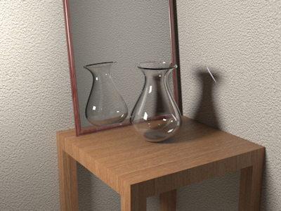

 - Caustics Photons
 - Caustics is a technique that mimics real light by calculating photons
                            that start at a light source. If Caustic Photons is enabled, these
                            photons are reflected, refracted, and bounce off the surface of a
                            mirror, for example. Some lights in your scene may not produce caustics;
                            for these, disable Caustics Photons to save rendering time.Note: This feature is not currently available in GPU+CPU mode.
                                                Figure 2. Caustics Off
                                                Figure 3. Caustics On - Shadow

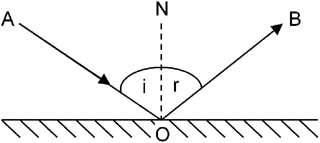

 - To place the light in the opposite direction, for the Placement Method, select Reflection. In the figure below, if A is the camera and O the point where you click, the light will be placed at point B. This feature allows the camera to receive the maximum amount of reflection.
 - To place the light on a surface, click the Place on Surface button, and then click the surface.
 - Define OB:
- To make OB equal to AO, for the Placement Distance, select Same as Camera to Point.
 - To define a custom OB, for the Placement Distance, select Custom, and then type a Distance Value.
