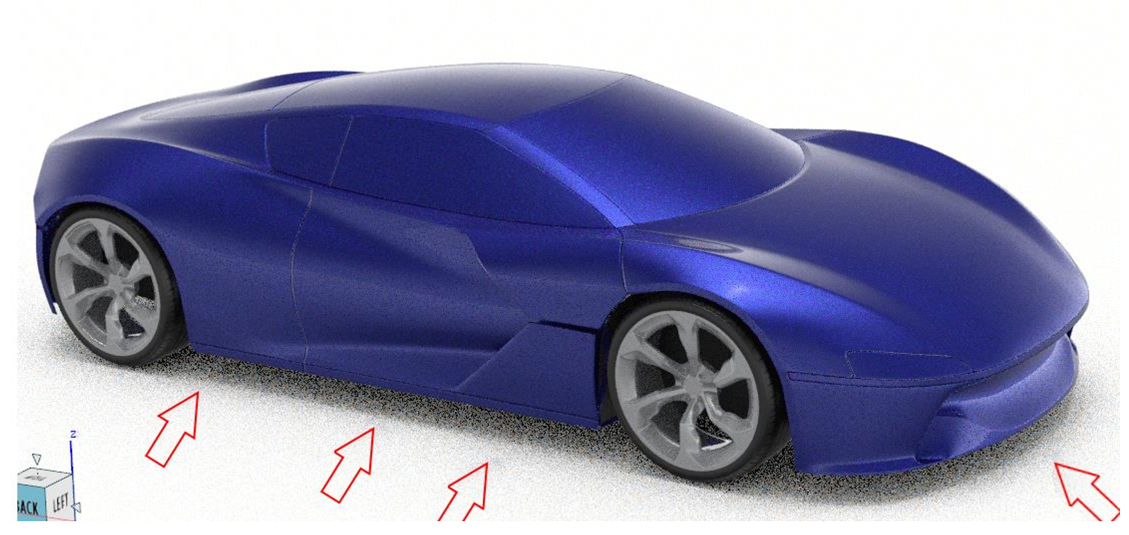

- Denoiser
 - Reduce the amount of noise/grains in the final rendered
                image.
- None (default)
 - Optix: To use Optix, you need a NVIDIA GPU with a
                  computing capability of 3.0 or higher and a driver version of 450.00 or
                    higher.Note: For RTX graphics cards, the NVIDIA drivers need to be higher than 418.81.
 - Intel: This open denoiser uses CPU and works with all graphic cards.
Note: To turn off the denoiser for interactive rendering, deselect Denoise Interactive Render.There are noise/grains around the bottom of the car, as indicated by the red arrows.
After applying a denoiser, noise/grains have been removed.

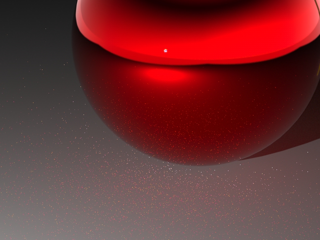

 - Adaptive Tracing
 - Select this option to solve difficult lighting situations to reduce noise, such as fireflies, indirect lighting, and caustic lighting. Typical use cases include an interior scene that is lit from the sun coming through small windows or scenes with lots of glass that generates caustics or pool caustics.
