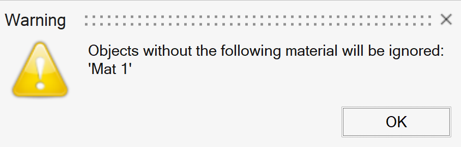

Note: If multiple objects with the same material are selected, you can scale and position the texture for all objects at the same time. The material of the first selected object is the reference material.If objects with other materials are also selected, they won't be affected by any changes but will remain selected. A message like this is displayed:

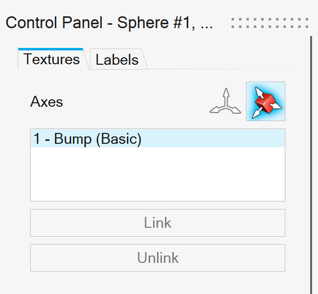

- On the Textures tab, click the texture you want to modify.
- Optional:
You can Link multiple textures so that their parameters
can be edited at the same time.

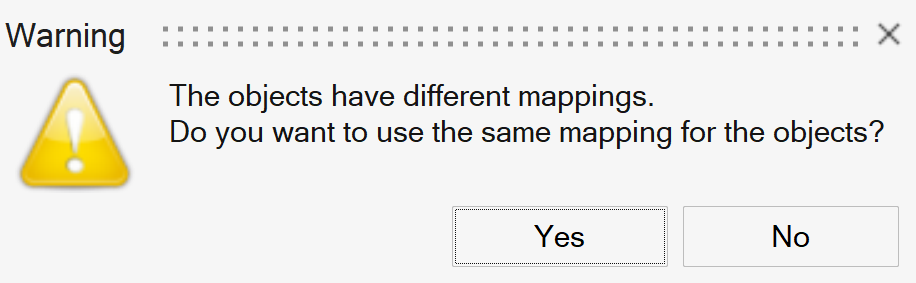

If multiple objects with the same material are selected, you can choose one of the Axes options to define how the mapping coordinates will affect the selected objects:
- Global: All objects have the same absolute origin and orientation.
- Local: The mapping of the first selected object is applied to the other objects along their local axes. This results in the same mapping for copied and rotated objects or instances.
- Yes: Copy the mapping of the first object to the others.
- No: The objects with different mapping won't be affected by any changes but will remain selected.
