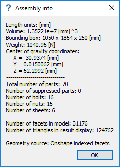

The hanger beam model in this tutorial has 70 parts, 16 bolts/nuts, and 32 washers.

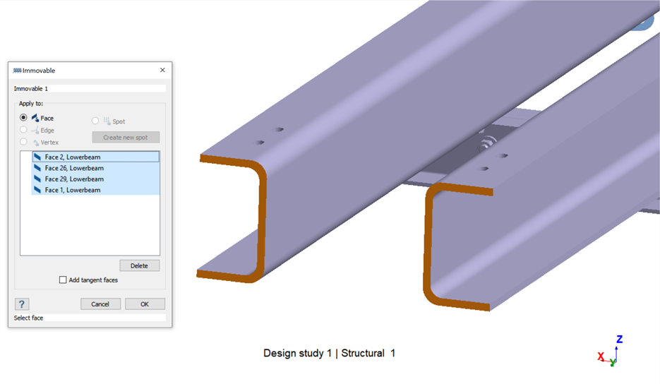

Create Immovable Supports
  1. In the Analysis Workbench, click Immovable Support .
  2. In the dialog, verify the Faces radio button is selected.
  3. In the modeling window, select the faces shown in Figure 3.
    Figure 3.
  4. Click OK.
    The new constraint, Immovable 1, appears in the Project Tree. A visual representation of the constraint is shown on the model.

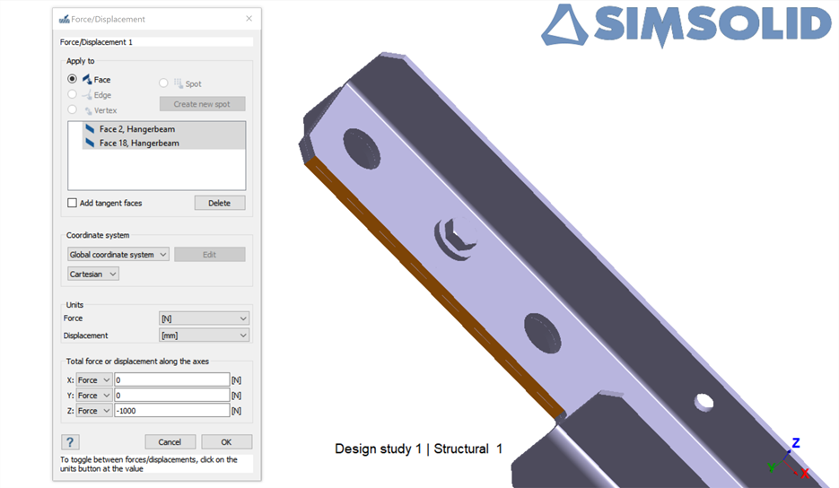

Create Force
  1. In the Analysis Workbench, click (Force/Displacement).
  2. In the dialog, ensure the Faces radio button is selected.
  3. In the modeling window select the faces shown in Figure 4.
    Figure 4.
  4. Specify a Z direction force of -1000 N.
  5. Click OK.
    The new force, Load/Displ. 1, appears in the Project Tree. Vectors representing the load are shown on the model.

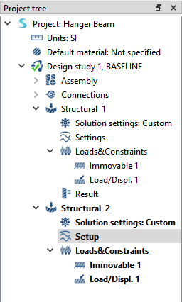

  1. In the Project Tree, right-click Structural 1 and choose Copy.
    The copy will appear as Structural 2 in the Project Tree.
  2. Under Structural 2, right-click on Setup and choose Edit.
    Figure 5.

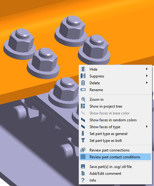

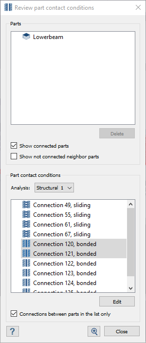

  2. In the modeling window, right-click on the Hanger beam (shown in orange) and select Review part contact conditions.
    Figure 8.
  3. In the dialog, hold down Control and click to select Connection 120 and Connection 121.
  4. Click the Edit contact conditions button.
    Figure 9.

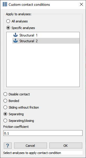

  5. In the Contact conditions dialog, select Structural 2.
  6. Activate the Separating radio button.
    Figure 10.
  7. For the Friction coefficient, specify 0.1.
  8. Click Close.

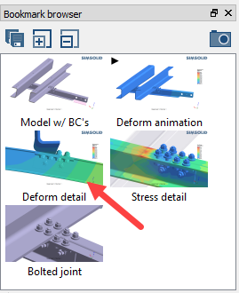

  2. In the Bookmark browser, choose Bookmark 3.
    This bookmark shows the deformation detail.
    Figure 11.

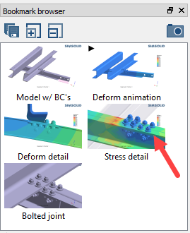

  5. Repeat steps 1 through 4 for Bookmark 4 (stress detail).
    Figure 12.

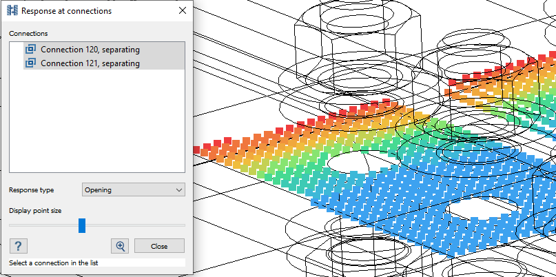

These forces are represented as colored values at each connection point (not a true contour). You used increased resolution when creating connections to get a denser array of points to plot.

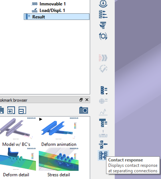

  1. In the Project Tree, select the Results branch under Structural 2.
  2. On the Analysis Workbench, select (Contact Response).
    Figure 13.
  3. In the Response at connections dialog, hold down Control and click to select Connection 120 and Connection 121.
  4. Select the response type you wish to view.
  5. Use the slider to increase or decrease the size of the colored points.
    Figure 14.
  6. Click Close.

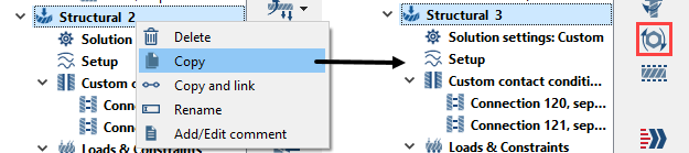

  1. In the Project Tree, right-click on Structural 2 and select Copy.
    The copy appears as Structural 3 in the Project Tree.

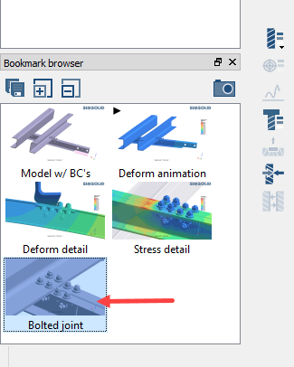

    Figure 15.
  2. In the Bookmark browser, select Bookmark 5 (Bolted joint).
  3. Verify Structural 3 is selected in the Project Tree.

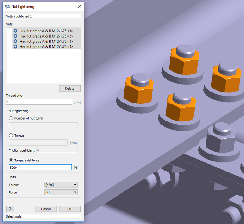

  4. In the Analysis Workbench toolbar, click (Nut tightening) .
  5. In the modeling window, select the 4 nuts attached to the hanger beam as shown in Figure 16.
    Figure 16.
  6. For Thread pitch, enter 1 mm.
  7. Activate the Target axial load radio button and enter 5000 N.
  8. Click OK.
