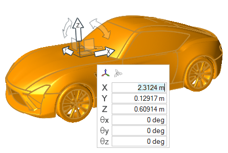

Translate and Rotate Objects
Use the Move tool to translate and rotate selected objects.
Figure 7.
Reposition the Move Tool
Reposition the Move tool along an axis, within a plane, or in 3D space to change the center of rotation.

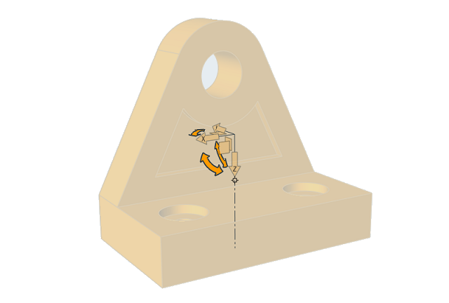

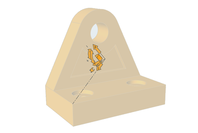

Align the Move Tool to a Feature
Align the x, y, or z axis of the Move tool to a point, an edge, or a face.
Figure 10. Move Tool Aligned to a Point
Figure 11. Move Tool Aligned to an Edge

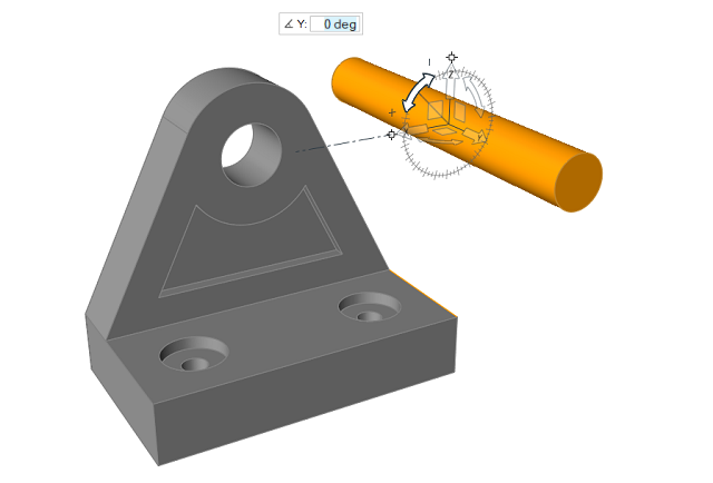

Align Objects to Features
Align objects to features such as points, edges, faces, and holes using the Move tool.

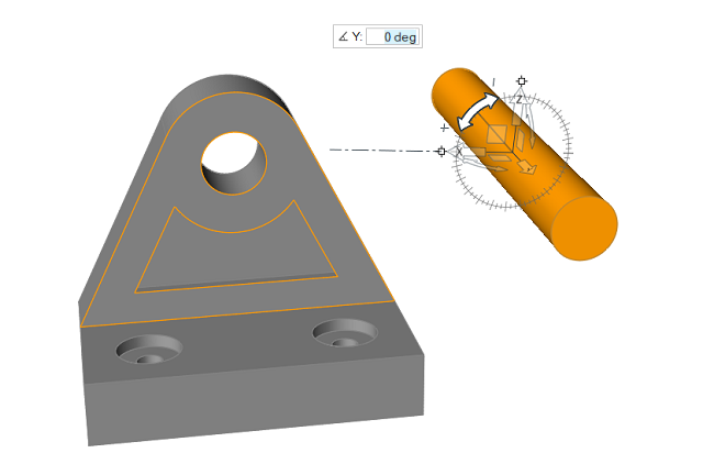

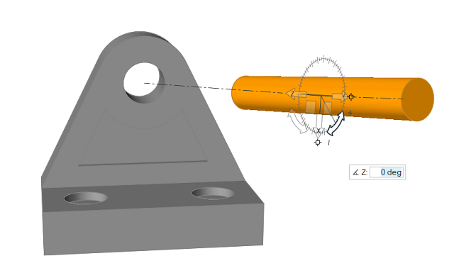

Figure 14. Object Aligned to a Point
Figure 15. Object Aligned to an Edge
Figure 16. Object Aligned to a Face
Figure 17. Object Aligned to a Hole
