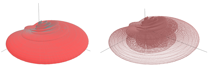

- To draw the antenna pattern with a wire frame, check the
Wireframe check box.Figure 4. Same colors – but wire frame enabled (left) and disabled (right).

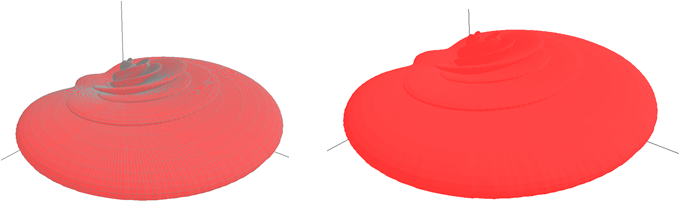

- To draw the antenna pattern with filled surfaces instead of a wire frame, check
the Surface check box.Note: If filled objects are selected, the computing time increases.Figure 5. Same colors – but filled surfaces enabled (left) and disabled (right).
