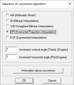

Figure 1. The Selection of conversion algorithm dialog.
For such a conversion the increments between the values to be interpolated can be defined to control the accuracy, the file size and the computation time.
- WinProp 2D antenna patterns
. Only binary files with the extensions .ahb (horizontal) and .avb (vertical) can be used.
- MSI / PLN antenna patterns: .
- Customer-defined antenna patterns: . This file format supports special formats of the customer (only if desired).

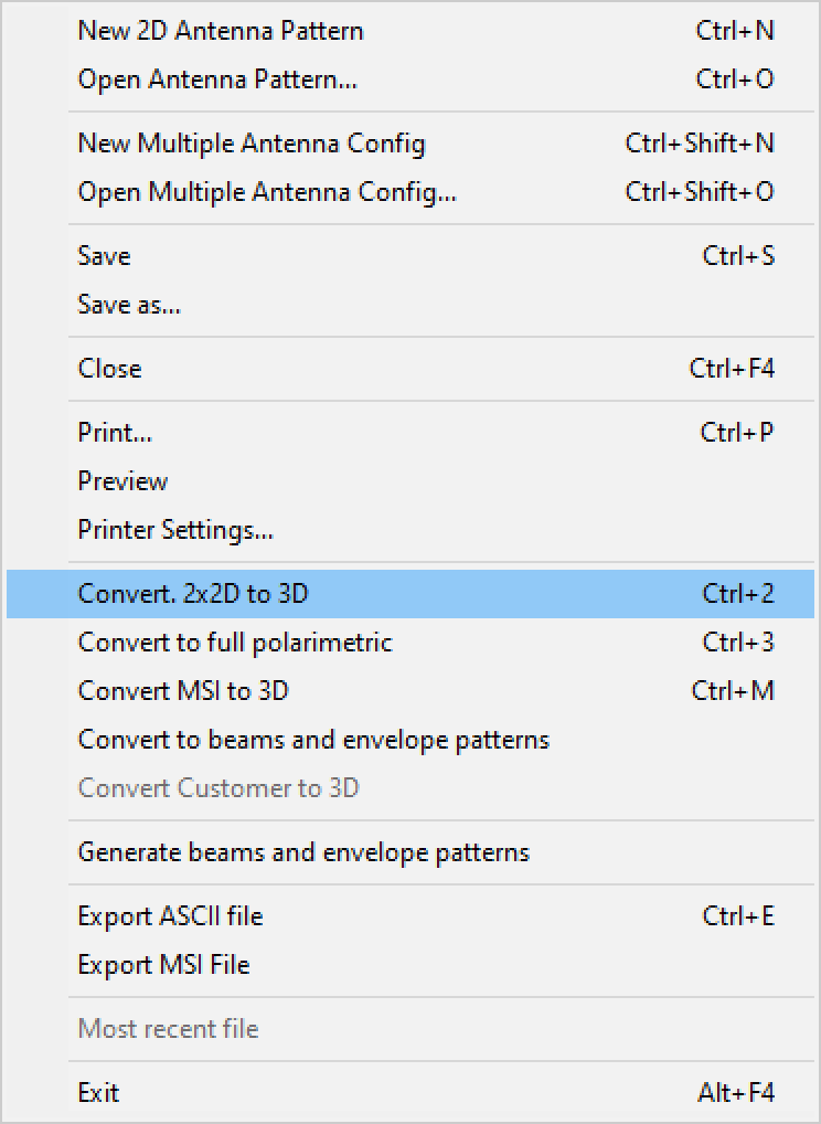

After selecting the settings of the conversion, the file(s) to be converted must be selected. Then the file is read, the conversion is computed, and the pattern is displayed in the 3D view.
