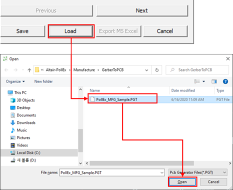

  4. Click Load and select the PollEx_MFG_Sample.pgt file from C:\Temp\Altair-PollEx\Manufacture\GerberToPCB.
  5. Click Open.
  6. Click Next.

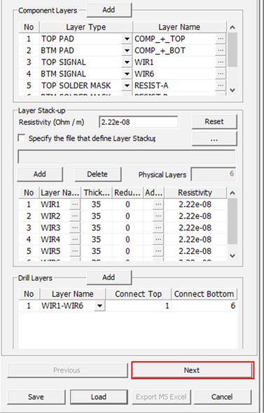

    The pre-defined PCB Generator Files sets the Component Layers and Drill Layers.

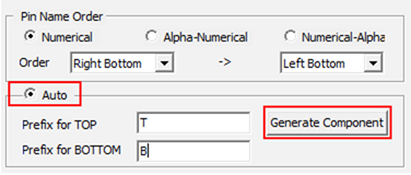

  7. Make component.
    1. Select Auto.
    2. For Prefix for TOP, enter T.
    3. For Prefix for BOTTOM, enter B.

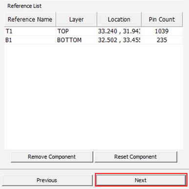

    4. Click Generate Component.
      The components are automatically generated.
      Figure 3.
      The generated lists for the TOP and BOTTOM are displayed in the Reference List.
    5. Click Next.

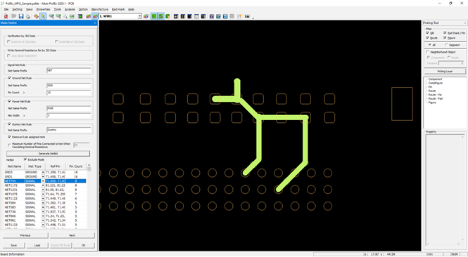

  8. Make Netlist.

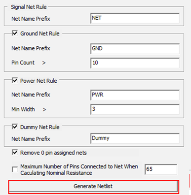

    1. Under Signal Net Rule, enter NET for Net Name Prefix.
    2. Under Ground Net Rule, enter GND for Net Name Prefix.
    3. Under Power Net Rule, enter PWR for Net Name Prefix.
    4. Under Dummy Net Rule, enter Dummy for Net Name Prefix.
    5. Enable the Remove 0 pin assigned nets checkbox.
    6. Disable the Maximum Number of Pins Connected to Net When Calculating Nominal Resistance checkbox.
    7. Click Generate Netlist.

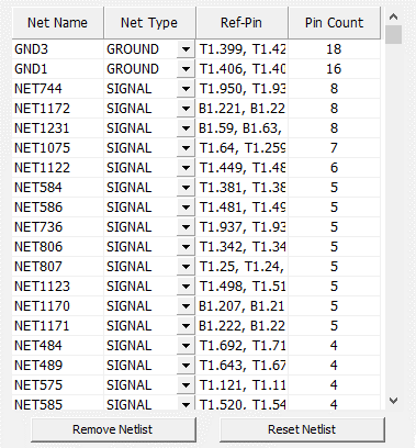

      Figure 5.

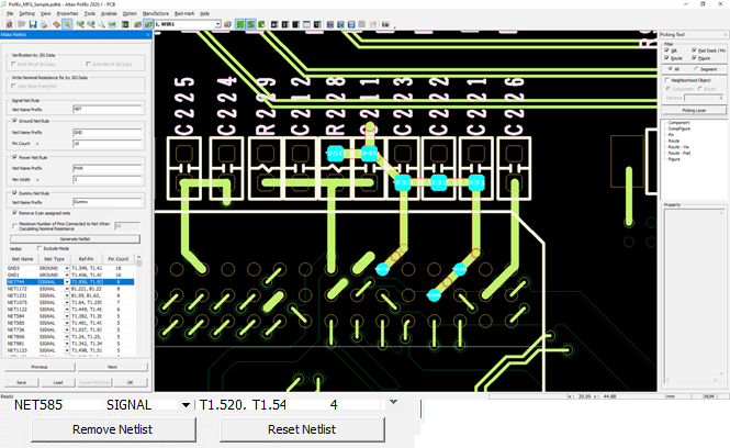

      The created Netlists are displayed in the table.
      Figure 6.
    8. Click NET737.
      The selected net is highlighted in the design.
      Figure 7.
    9. Enable the Exclude Mode checkbox.
      Only the selected net is displayed.
      Figure 8.

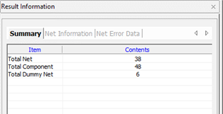

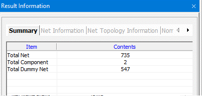

  9. Review result information.
    The result is displayed in each category such as: Summary, Net Information, Net Topology Information, and Nominal Resistance.
    Figure 9.
    1. In each tab, click a Net Name.
      The selected net is displayed in the design.

  7. Define layer setting.
    There are two ways to set the layers, manually or by loading a predefined environment file.
    1. For Top Soldermask, select c-mask.pho.
    2. For Bottom Soldermask, select s-mask.pho.
      Figure 12.

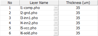

  8. Define Layer Stack-up.
    1. Click Add six times.
    2. For 1, select l1-comp.pho for Layer Name.
    3. For 2, select l2-gnd.pho for Layer Name.
    4. For 3, select l3-inn1.pho for Layer Name.
    5. For 4, select l4-inn2.pho for Layer Name.
    6. For 5, select l5-vcc.pho for Layer Name.
    7. For 6, select l6-sold.pho for Layer Name.
    Figure 13.

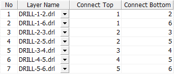

  9. Define Drill Layers.
    1. Click Add seven times.
    2. Select layer names and enter the Connect Top and Connect Bottom values as shown in Figure 14.
    Figure 14.

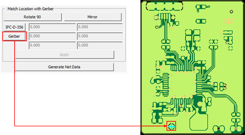

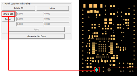

  12. Match the Location of Gerber and IPC data.
    1. Click IPC-D-356.
    2. Click the component in the IPC data.
      Figure 16.
    3. Click Gerber.
    4. Click the component in the Gerber data.
      Figure 17.

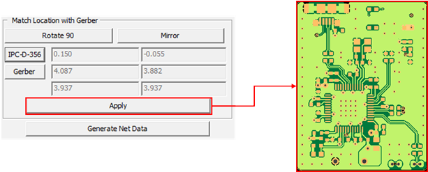

      Selected coordinates are automatically entered in the table.
    5. Click Apply.
      The data will be matched by moving the IPC data to the Gerber data based on the selected component on each design.
      Figure 18.
    6. Click Generate Net Data.
