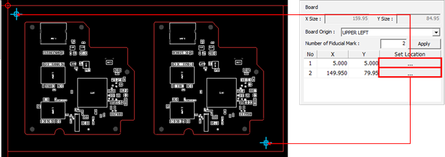

    1. From the General tab of the Underfill dialog, select UPPER LEFT for Board Origin.

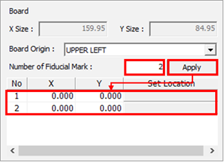

    2. For Number of Fiducial Mark, enter 2 and click Apply.
    3. Click Set Location.
    4. Click the location of the fiducial mark.
      The X/Y coordinates are entered.

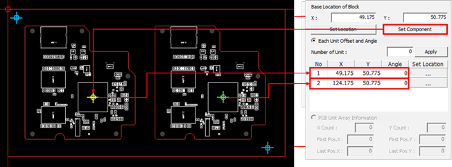

    5. Click Set Component and select the U1 component from the PCB data.
      Figure 4.
      The center coordinate of the selected component is set as the base location and the same part coordinates of each unit PCB are automatically registered.

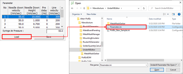

    6. Click Load and select the Parameter.ini file from C:\Temp\Altair-PollEx\Manufacture\Underfill.
      Figure 5.

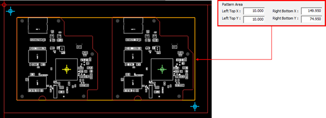

    7. Set the area where the nozzle movement pattern for the underfill application is drawn.
      Figure 6.

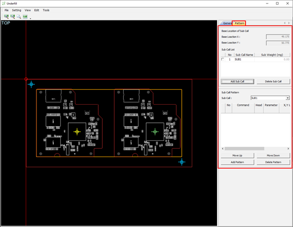

  5. Define Pattern settings.
    Figure 7.

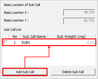

    1. In the Pattern tab, click Add Sub Call to register new sub call.
      Figure 8.
      When applying multiple times, multiple sub calls can be registered.

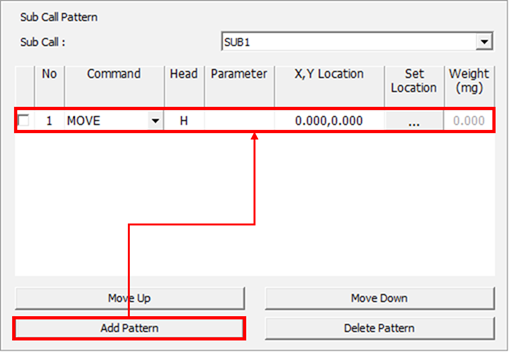

    3. Click Add Pattern to create a new pattern.
      Figure 10.

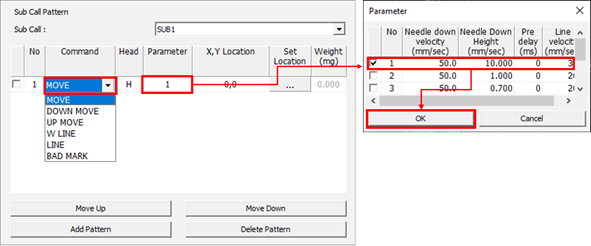

    4. For Command, select Move.
    5. Double-click the Parameter column.
      The Parameter dialog opens.
    6. In the Parameter dialog, enable the checkbox for the first parameter and click OK.
      Figure 11.

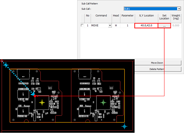

    7. Click in the Set Location column and click the location where the nozzle will move on the work screen.
    8. Double-click the X,Y Location column to edit the coordinates.
      The nozzle of the underfill dispenser will move from (0,0) to (42.0, -42.0). The moving speed and the height of the nozzle depend on the value of the first parameter selected.

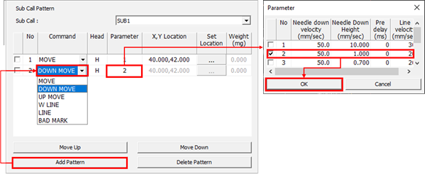

    9. Click Add Pattern.
    10. For Command, select DOWN MOVE and select the parameter number two.
    11. Double-click the Parameter column.
    12. In the Parameter dialog, enable the checkbox for the second parameter and click OK.
      The nozzle of the underfill dispenser moves down to the height set by the selected second parameter.
      Figure 13.

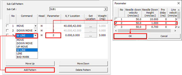

    13. Click Add Pattern.

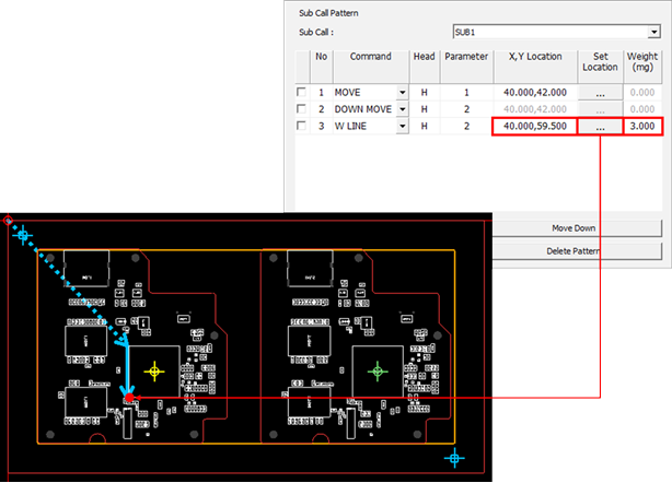

    14. For Command, select W Line.
    15. Double-click the Parameter column.
    16. In the Parameter dialog, enable the checkbox for the second parameter and click OK.
      Figure 14.
    17. Click in the Set Location column and set the position to move the nozzle on the work screen.
    18. For Weight (mg), enter 3.
      The nozzle of the underfill dispenser moves from (40.0,42.0) to (40.0,59.5) and applies 3mg of the underfill solution. The moving speed and height of the nozzle depend on the value of the second parameter.

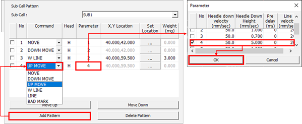

    19. Click Add Pattern.

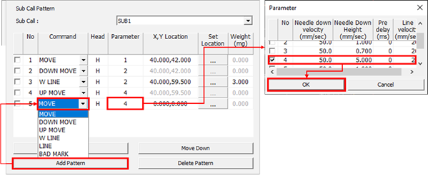

    20. For Command, select UP MOVE.
    21. Double-click the Parameter column.
    22. In the Parameter dialog, enable the checkbox for the fourth parameter and click OK.
      The underfill dispenser nozzle moves up to the height set by the fourth parameter.
      Figure 16.

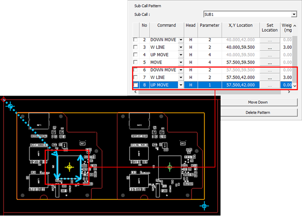

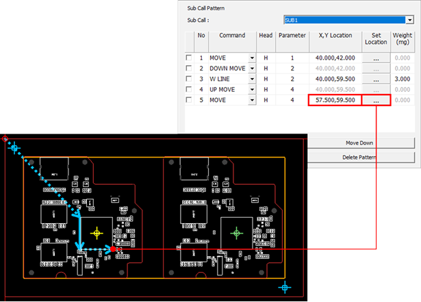

    23. Click Add Pattern.
    24. For Command, select MOVE.
    25. Double-click the Parameter column.
    26. In the Parameter dialog, enable the checkbox for the fourth parameter and click OK.
      Figure 17.
    27. Click in the Set Location column and set the location where the nozzle will move on the work screen.
      Figure 18.
    28. Repeat steps 5.i5.aa to complete the pattern as shown below.
      Figure 19.
