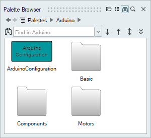

- Arduino Palette and Configuration Block
The Configuration block is mandatory and must be included and properly parameterized in a given Activate diagram.
In particular, the COM port is defined on this block. On a personal computer system, the COM port is emulated by the USB port. The Arduino board is connected to the USB port of the computer. The actual COM port assigned by Windows is indicated by the Windows Device Manager. This information is required to define the Configuration block.
- Basic Palette
- The Basic palette includes a general set of blocks for building Arduino
components in Activate diagrams.

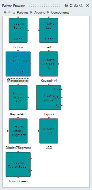

- Components Palette
- The Components palette includes Arduino components that you can add to Activate diagrams.

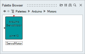

- Motors Palette
- The Motors palette includes the Arduino Servo Motor that you can add to
Activate diagrams.
