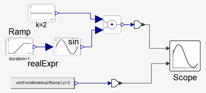

The use of FromModelica allows other Modelica constructions, which are even less Activate-like. In Modelica, not only can a component parameter depend on other components’ parameters, but its output can also depend on other block parameters and even outputs or inputs. This can be seen in the following example, where the expression of the ModelicaRealExpression block depends on the output of another
            block (Ramp in this case). The FromModelica function
            is used to retrieve, not a parameter of the Ramp block, but its
                output.
