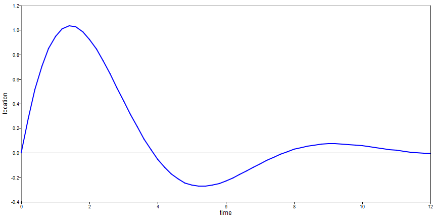

Example
Find the location in a mass spring damper system:
function dy = MSD(t,y,m,k,c)
  % y = [x, dx/dt]
  dy = [0, 0];
  dy(1) = y(2);
  dy(2) = -y(1)*(k/m) - y(2)*(c/m);
end
v = 1.5;  % initial velocity
m = 1.6;  % mass
k = 1.25; % spring constant
c = 1.1;  % damping constant
handle = @(t,y) MSD(t,y,m,k,c);
t = [0:0.2:12]; % time vector
yi = [0, v];
[t,y] = ode45(handle,t,yi);
x = y(:,1)';
plot(t,x);
xlabel('time');
ylabel('location');
Figure 1. chirp figure 1
