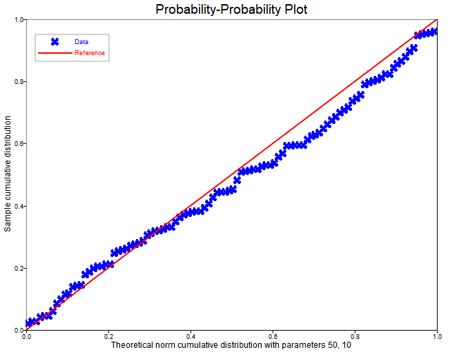

Examples
Compare a Chi-squared sample with 50 degrees of freedom to the normal distribution with mean 50 and standard deviation 10.
rand('seed', 2023);
n = 100;
data = chi2rnd(50,n,1);
ppplot(data, 'norm', 50, 10);
Figure 1. ppplot
Comments
The function plots the sorted cumulative probabilities of X, assuming dist, on the vertical axis, with a set of perfectly spaced cumulative probabilities on the horizontal axis. The perfectly spaced cumulative probabilities for N points are selected to be ([1:N] - 1/2) / N.
If X has distribution dist then plot is expected to fall on the straight line from (0,0) to (1,1), which is plotted to provide a visual reference.
