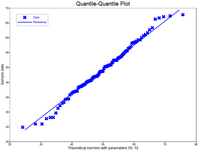

Compare a Chi-squared sample with 50 degrees of freedom to the normal distribution with mean 50 and standard deviation 10.
rand('seed', 2023);
n = 100;
data = chi2rnd(50,n,1);
qqplot(data, 'norm', 50, 10);
Figure 1. qqplot
Comments
The function plots the empirical quantiles of X on the vertical axis, with either the empirical quantiles of Y or the theoretical quantiles of the specified distribution, dist, on the horizontal axis. The quantiles are selected so that for N points the cumulative probabilities are ([1:N] - 1/2) / N.
If the two quantile sets have the same distribution then the plot is expected to fall on a straight line. The function also plots a line that passes through the first and third quantile points to provide a visual straightness reference.
