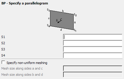

On the Construct tab, in the Surfaces group,
click the Plate (BP) icon.
Figure 1. The BP - Specify a parallelogram dialog.
Parameters:
S1, S2, S3, S4
The points S1 to S4 are the four corner points of the parallelogram. These points
should have been defined previously with DP cards.
Specify non-uniform meshing
Normally, a parallelogram is segmented according to the edge length specified with the
IP card. When creating small microstrip lines, it may be desirable to use a finer
segmentation in one direction. Check this item if a finer segmentation is required in
one direction. The mesh sizes are in m and are scaled by the SF card.
Mesh size along sides a and c
Edges S1-S2 and S3-S4
Mesh size along sides b and d
Edges S2-S3 and S4-S1
The points are connected in the order that they appear in the BP card. Thus the user has
to ensure that the points describe a parallelogram. If this is not the case, then PREFEKO
will abort with the appropriate error message.
The direction of the normal vector of the subdivided triangles is determined by the right
hand rule through all corners. This direction is only important when used with physical optics (PO card), dielectrics (ME card), or with the combined field integral equation (CF card).
