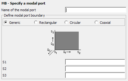

click the Modal boundary (MB) icon.
Figure 1. The MB - Specify a modal port dialog.
Parameters:
- Name of the modal port
- The label of the modal port.
- Define modal port boundary
- Rectangular
- A rectangular waveguide cross section is used, which is defined by three points S1, S2, and S3 as follows: S1 is an arbitrary corner point, and S2 and S3 are two corner points which define the waveguide sides (from S1 to S2) and (from S1 to S3). The direction in which the mode is launched is given by .
- Circular
- A circular waveguide cross section is used. The point S1 denotes the centre of the circular port, and the point S2 specifies the radius and start point for the angular dependency. A further point S3 must be perpendicular above the centre of the circular plate, so that the direction from S1 to S3 indicates the direction in which the waveguide modes are launched.
- Coaxial
- Here a feed of a coaxial waveguide with circular cross sections of both the inner and outer conductor can be specified. The point definitions are the same as for the circular waveguide, except that an additional point S4 must be defined between S1 and S2 which specifies the radius of the inner conductor.
- S1
- Point S1 situated on the FEM modal boundary.
- S2
- Point S2 situated on the FEM modal boundary.
- S3
- Point S3 situated on the FEM modal boundary.
