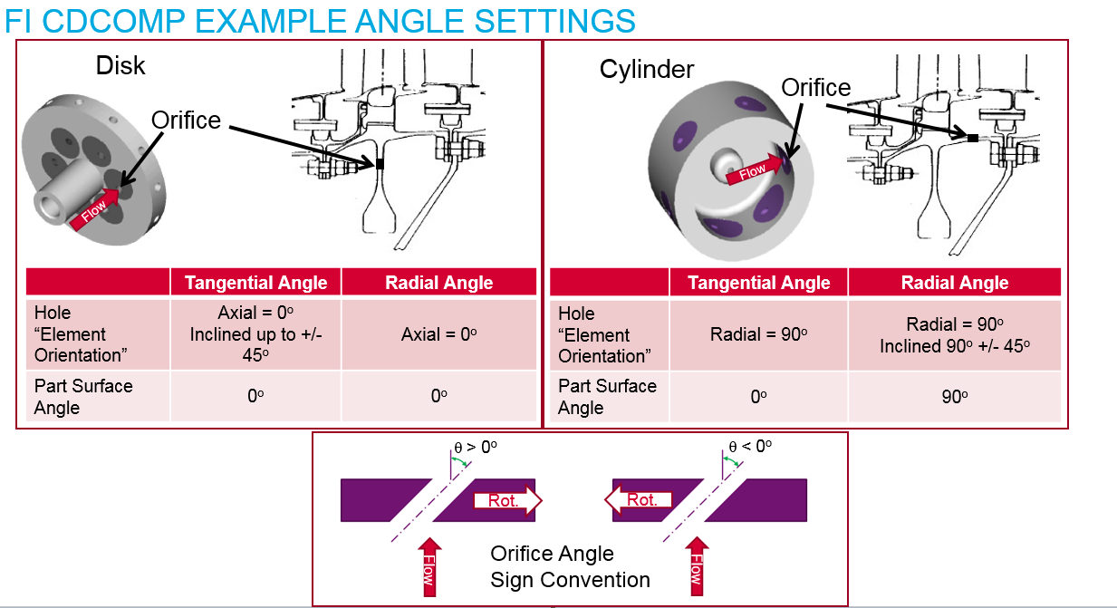

The correct “Part Surface Angle” and “Element Orientation” are critical for an accurate flow incidence angle. One thing to remember is that if the hole centerline is perpendicular to the part surface the “Part Surface Angle” and “Element Orientation” are the same. The “Part Surface Angle” and “Element Orientation” will only be different if the hole is at an angle to the part surface. Examples of “Part Surface Angle” and “Element Orientation” are shown below.

| 11 | Element Inlet Orientation: Tangential Angle (THETA) | Angle between the element centerline at the entrance of the
element and the reference direction. If the element is rotating or directly connected to one or more rotating elements, the reference direction is defined as parallel to the engine centerline and the angle is the projected angle in the tangential direction. Otherwise, the reference direction is arbitrary but assumed to be the same as the reference direction for all other elements attached to the upstream chamber. Theta for an element downstream of a plenum chamber has no impact on the solution. |
| 12 | Element Inlet Orientation: Radial Angle (PHI) | Angle between the element centerline at the entrance of the
element and the THETA direction (spherical coordinate system). Phi for an element downstream of a plenum chamber has no impact on the solution. |

| 23 | Part Surface Angle: Tangential (THETA_SNORM) | Part surface normal vector tangential angle
(degrees). *Uses the same angle convention as the orifice itself. For example, if the hole is drilled normal to the part surface, the THETA_SNORM should be set equal to THETA) Default is 0.0. |
| 24 | Part Surface Angle: Radial (PHI_SNORM) | Part surface normal vector radial angle . |

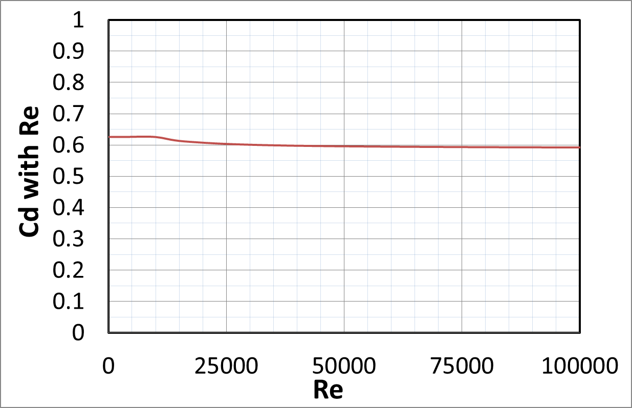

Reynolds Number Effect
The first step is the related to the hole Reynolds number (Re). The Reynolds number is based on the “ideal” velocity through the hole.
For an orifice:
Figure 2. For a nozzle:
The Cd is not very sensitive to the Re. The minimum Re used in this equation is 10,000. The Cd used as the basis for the next step is always around 0.6 for an orifice.

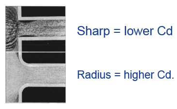

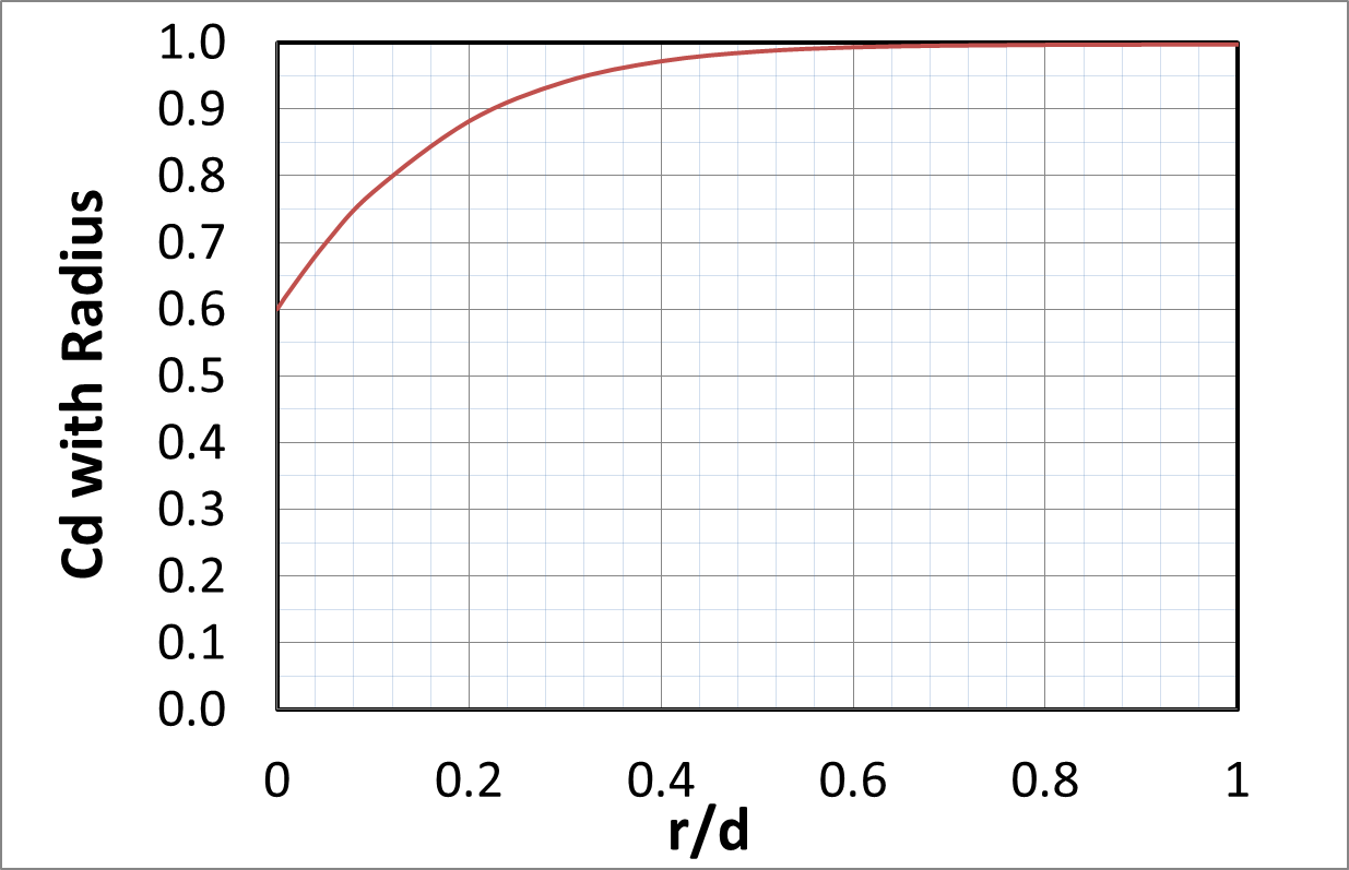

Hole Corner Fillet or Chamfer
A fillet or chamfer can significantly reduce the losses in the hole (a higher Cd).
For a hole with a circular fillet (McGreehan Fillet, ref 1):
Figure 3.
Figure 4. The example shows streamlines entering a hole with a sharp corner and a hole with a large fillet. The hole with a sharp corner shows flow separation while the hole with a radius does not. The plot demonstrates the radius effect and may not represent the final Cd.

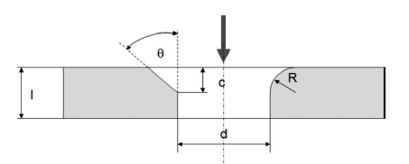

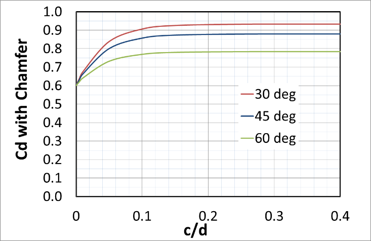

For a hole with a chamfer (Idris Chamfer, ref 1):
Figure 5.
Figure 6. The plot demonstrates the radius effect and may not represent the final Cd.

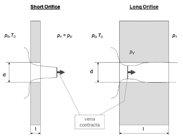

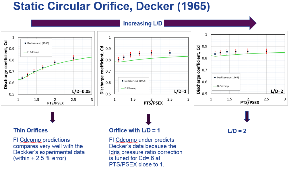

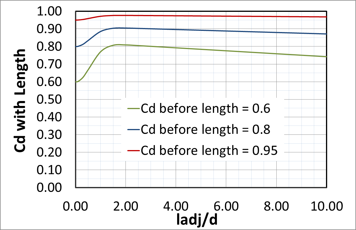

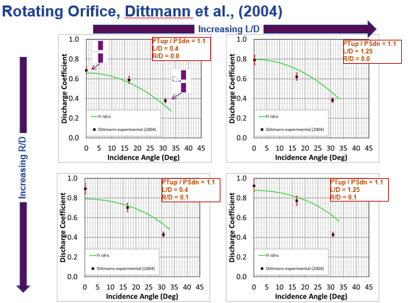

Orifice Length over Diameter (L/D)
The length of the orifice affects the reattachment of the orifice flow. If the flow can reattach inside the orifice length the losses can be reduced (Cd increased). The program adjusts the length due to a fillet or chamfer so the user should enter the orifice length as if there was no fillet or chamfer. The program does not adjust the length for the hole angle. The user should enter a hole length that includes the angle effect. Equation taken from Huning, ref. 2.
Figure 7.
Figure 8. The plot demonstrates the length effect and may not represent the final Cd. Note that the maximum Cd occurs between L/D = 1.5 and 2. Friction losses increase as the orifice gets longer so Cd decreases for L/D > 2

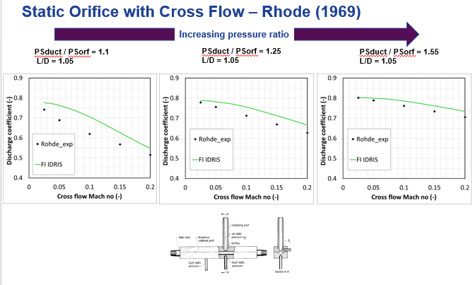

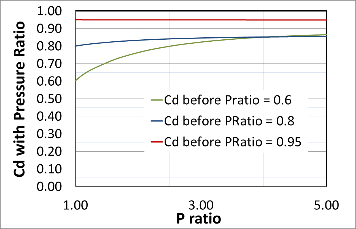

Ratio of Pressure Upstream and Downstream of the Hole
The pressure ratio effect accounts for the compressibility of the gas. It will have no affect for liquid (incompressible) fluids. The maximum pressure ratio used in this equation is 5.0. As the pressure ratio increases the vena contracta increases to cause the higher Cd. Equation taken from Idris, ref. 1.
Figure 9. The plot demonstrates the pressure ratio effect and may not represent the final Cd. Note that the Cd increases after the choking pressure ratio (~1.9). So, the orifice flowrate may increase after the PR exceeds the choking PR.

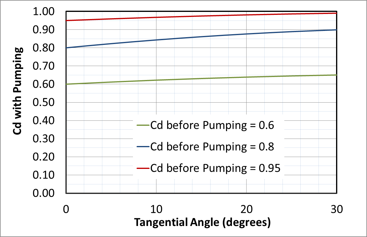

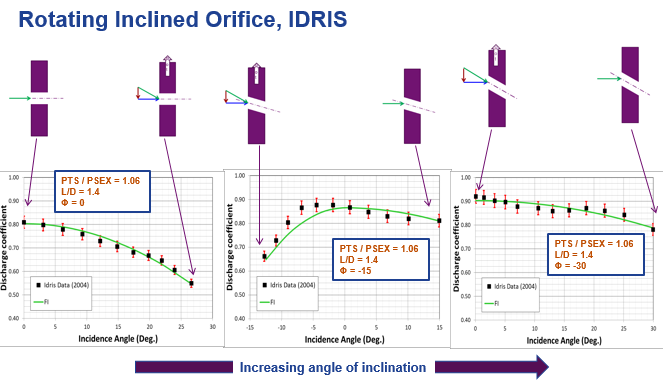

Pumping to Account for Hole Angle and Rotation
Idris (ref 1) describes a pumping effect that accounts for the fact that the Cd for Incidence angle = 0o is higher for a rotating hole (which must be angled to achieve zero incidence) that it is for a stationary hole. The physics behind this are not clear. The effect is included to match the Idris data, ref. 1.
Figure 10. The plot demonstrates the pumping effect and may not represent the final Cd.

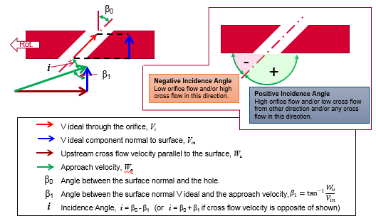

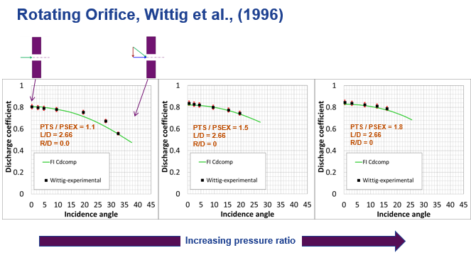

Incidence Angle of the Flow Approaching the Hole
The final Cd is very sensitive to the incidence angle effect. If the upstream flow approaches a hole at a steep angle a large separation region can fill a significant portion of the hole. This will decrease the Cd and flowrate. The incidence angle affects are taken from ref 1. The hole corner treatment and the angle of the hole influence the incidence angle effect.

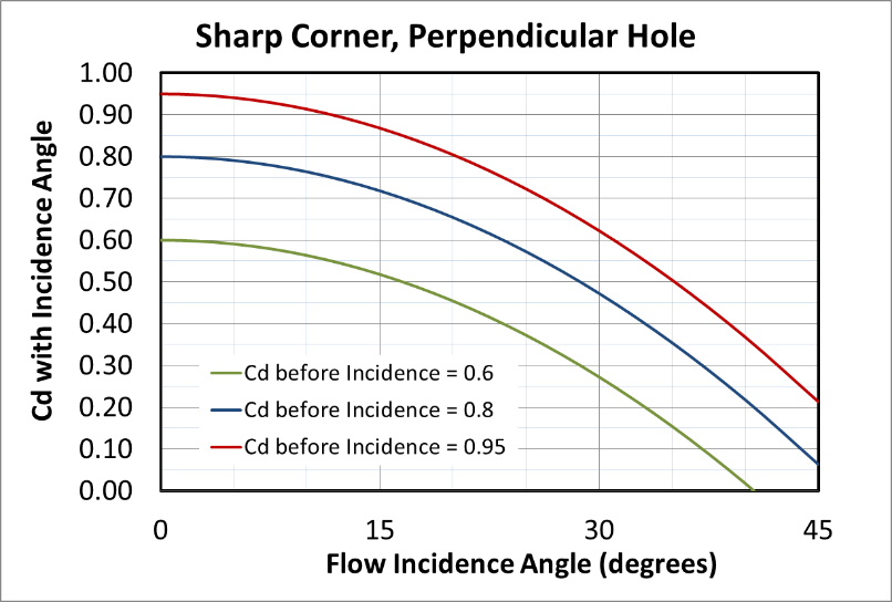

For holes that are perpendicular to the part surface:
For a hole with a sharp corner (Idris):
Figure 11. The plot demonstrates the incidence effect and may not represent the final Cd. The absolute value of the incidence angle is used in this equation. The maximum incidence angle allowed is 45o.

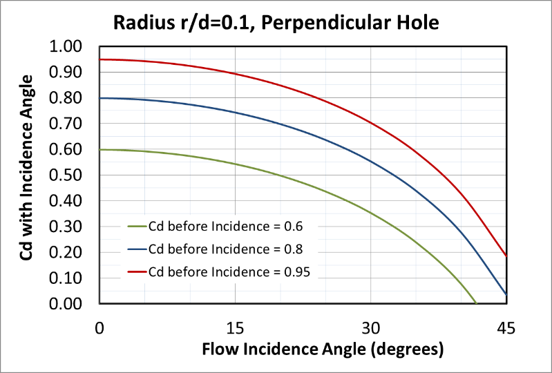

For a hole with a circular fillet (Idris):
Figure 12. The plot demonstrates the incidence effect and may not represent the final Cd. The absolute value of the incidence angle is used in this equation. The maximum incidence angle allowed is 45o. The maximum r/d allowed is 0.25 .

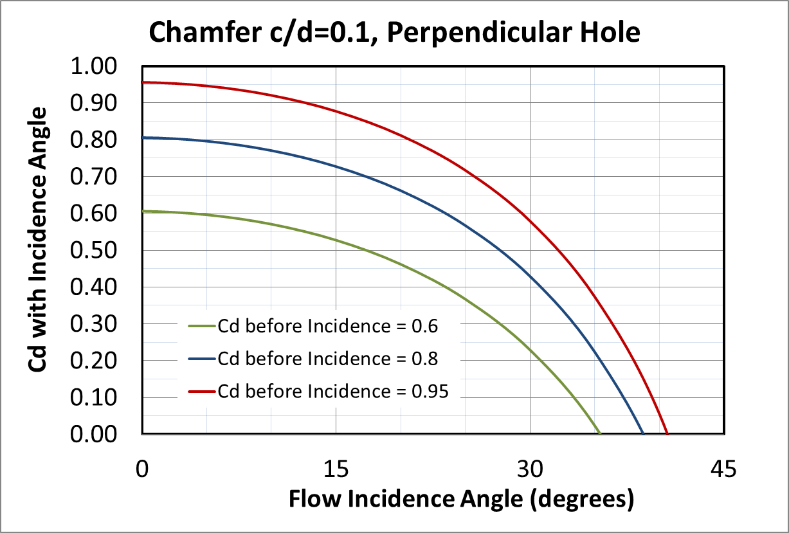

For a hole with a chamfer (Idris):
Figure 13. The plot demonstrates the incidence effect and may not represent the final Cd. The absolute value of the incidence angle is used in this equation. The maximum incidence angle allowed is 30o. The maximum c/d allowed is 0.20.
There is also an equation from Huning (ref 2) for holes that are perpendicular to the surface. The same equation is used for all corner types (sharp, fillet, and chamfer).
Figure 14.

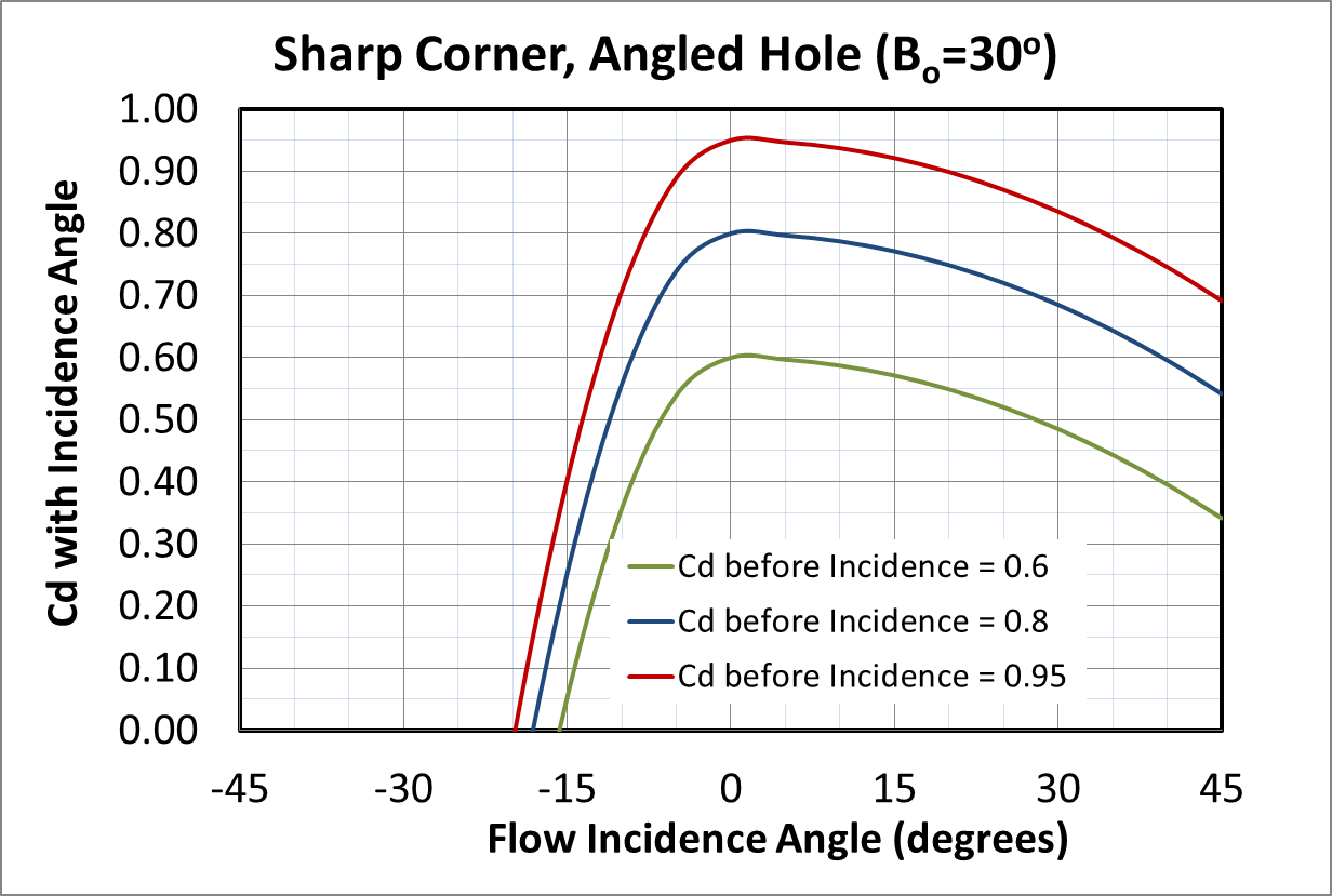

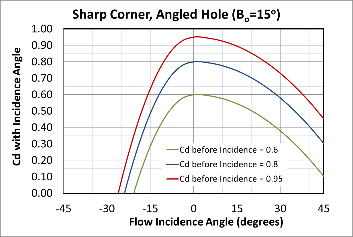

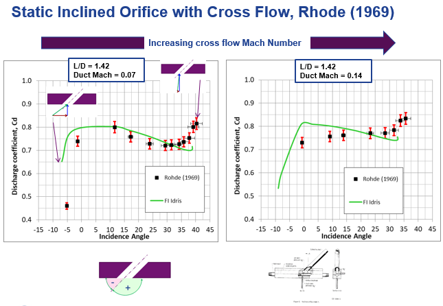

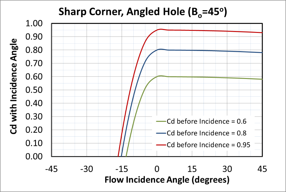

For holes that are angled to the part surface:
There is no data available for the incidence angle effect on an angled hole with a fillet or chamfer. The sharp corner Cd will be used even if the hole has a fillet or chamfer. The effect is different for holes with positive and negative incidence.
Figure 15. For a hole with a sharp corner (Positive incidence) :
For a hole with a sharp corner (Negative incidence) :
The following plots show the effect of incidence angle on holes that have a 15o, 30o, and 45o angle with the part surface. The plots demonstrate the incidence effect and may not represent the final Cd.
Figure 16.
Figure 17.

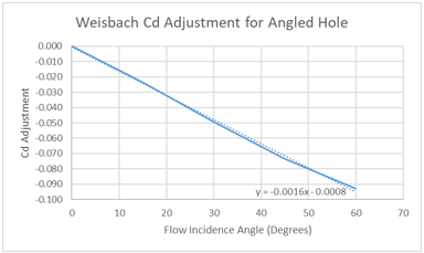

Figure 18. Weisbach Adjustment for Angled Hole
The Weisbach adjustment for an angled hole is valid when the upstream velocity is 0, in other words, a plenum chamber is upstream of the Cdcomp element. It is based on the following equation from Weisbach, but can also be found in Ref 9.
The K is converted into a Cd using Cd=1/sqrt(1+K) to get an adjustment to the previous Cd.

FI CDComp Validation
The FI CDComp results were compared to Cd and flow results from various tests as shown below.
Figure 20.
Figure 21.
Figure 22.
Figure 23.
Figure 24.
