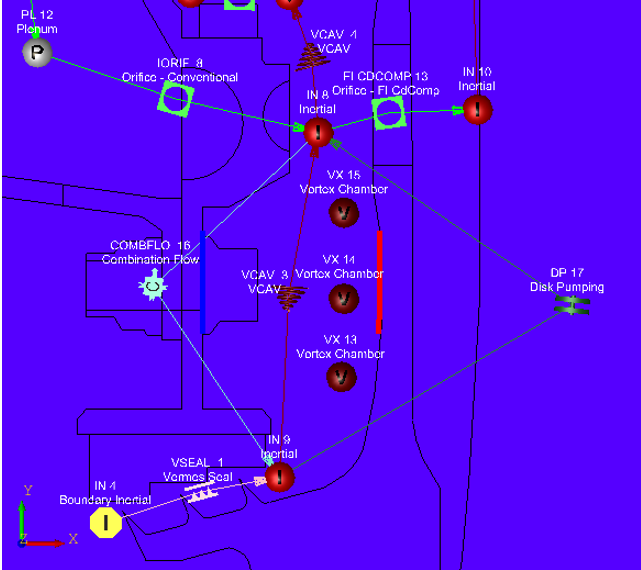

The disk pumping element models such situations and calculates the mass flow rate of this pumped flow over the disk.

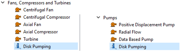

Disk Pump Creation in the Graphical User Interface

| 8 | Vortex ID (VORTEX_ELEM) | This option is displayed when you select Select
Vortex Element from the Input Type. You can either pick the vortex element or manually enter the vortex element ID that you want the disk pumping to be associated with. Using the user-selected vortex element, the solver automatically populates the Number of Segments, Swirl Chambers table, and Radii table. |

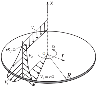

Figure 1 illustrates the boundary layers forming on a rotating disk when the fluid outside the boundary layer itself rotates as a forced vortex at a fraction of the disk angular velocity. The swirl factor Sf lies between 0 and 1. The maximum pumped flow rate occurs when Sf = 0. When Sf = 1, the fluid gets into solid-body rotation with the disk with no pumping flow. The boundary layers in this case become turbulent for Re = , the local rotational Reynolds number.
The disk pumping element is divided into multiple segments; each segment has a vortex or inertial chamber associated to it. The beginning and end of each segment is represented as a “station” with one more station than the number of segments. Each station has a radius which is determined by the chamber associated to the segment. The swirl factor for each segment is calculated. The angular velocity for each segment is retrieved from the reference rotor the disk is connected to. The swirl factor must be relative to the surface RPM of the disk. Using the fluid properties and inner and outer radii, the local Reynolds number is calculated.
