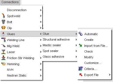

Automatic creation
All the uncreated glues can be created automatically:
| • | Open the Connections > Glue > Automatic. |
Manual creation
LS-DYNA selection
| • | Select Glues > [glue type] > Create. |
Part selection
Button
